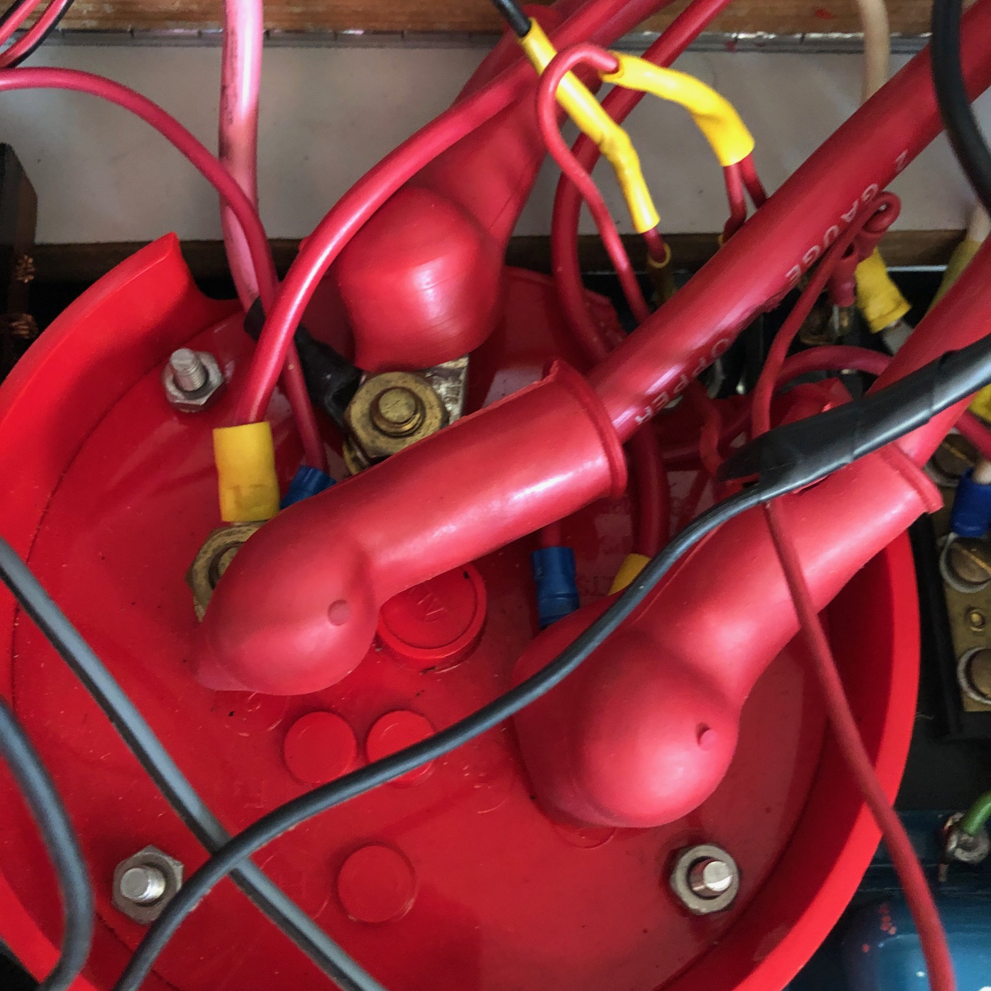

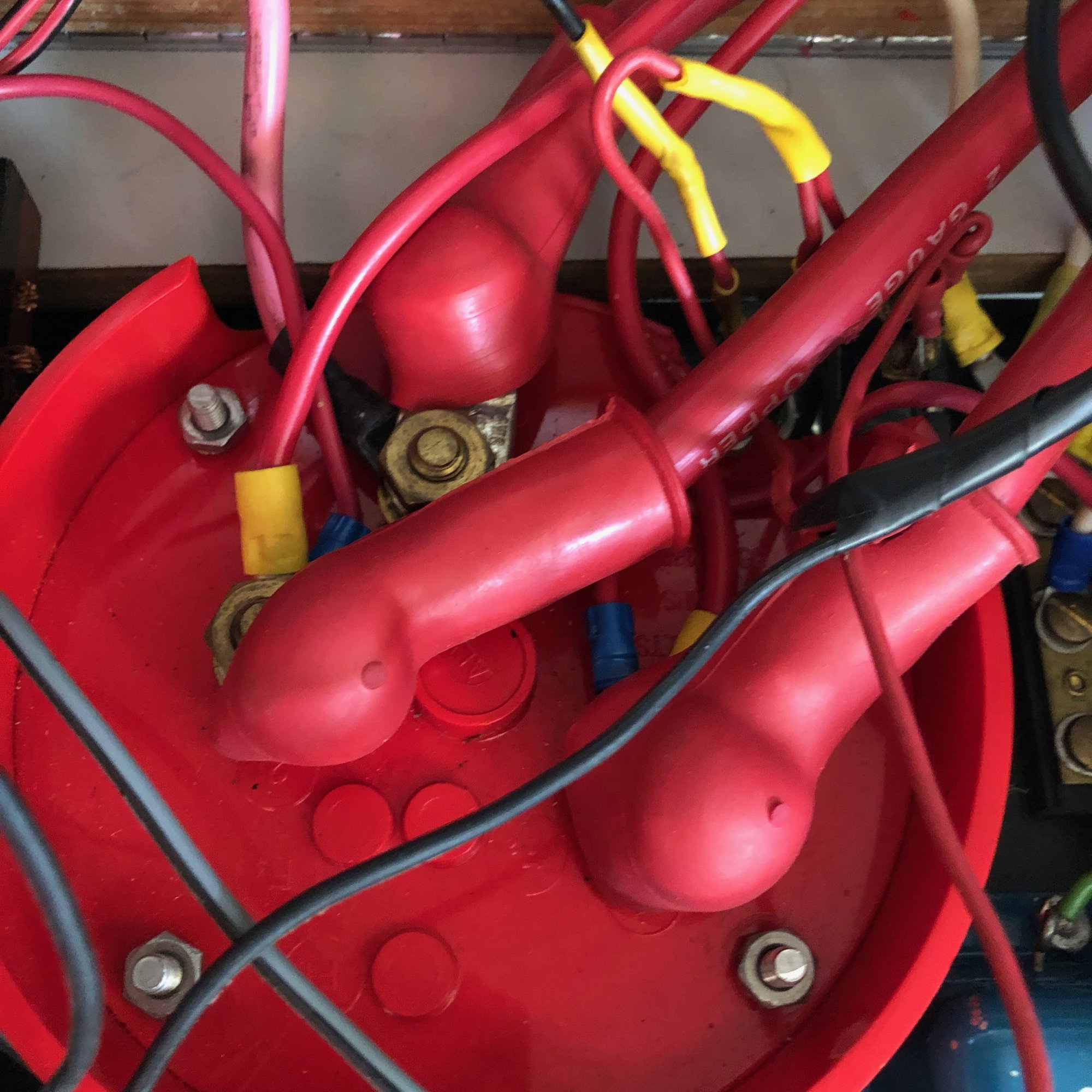

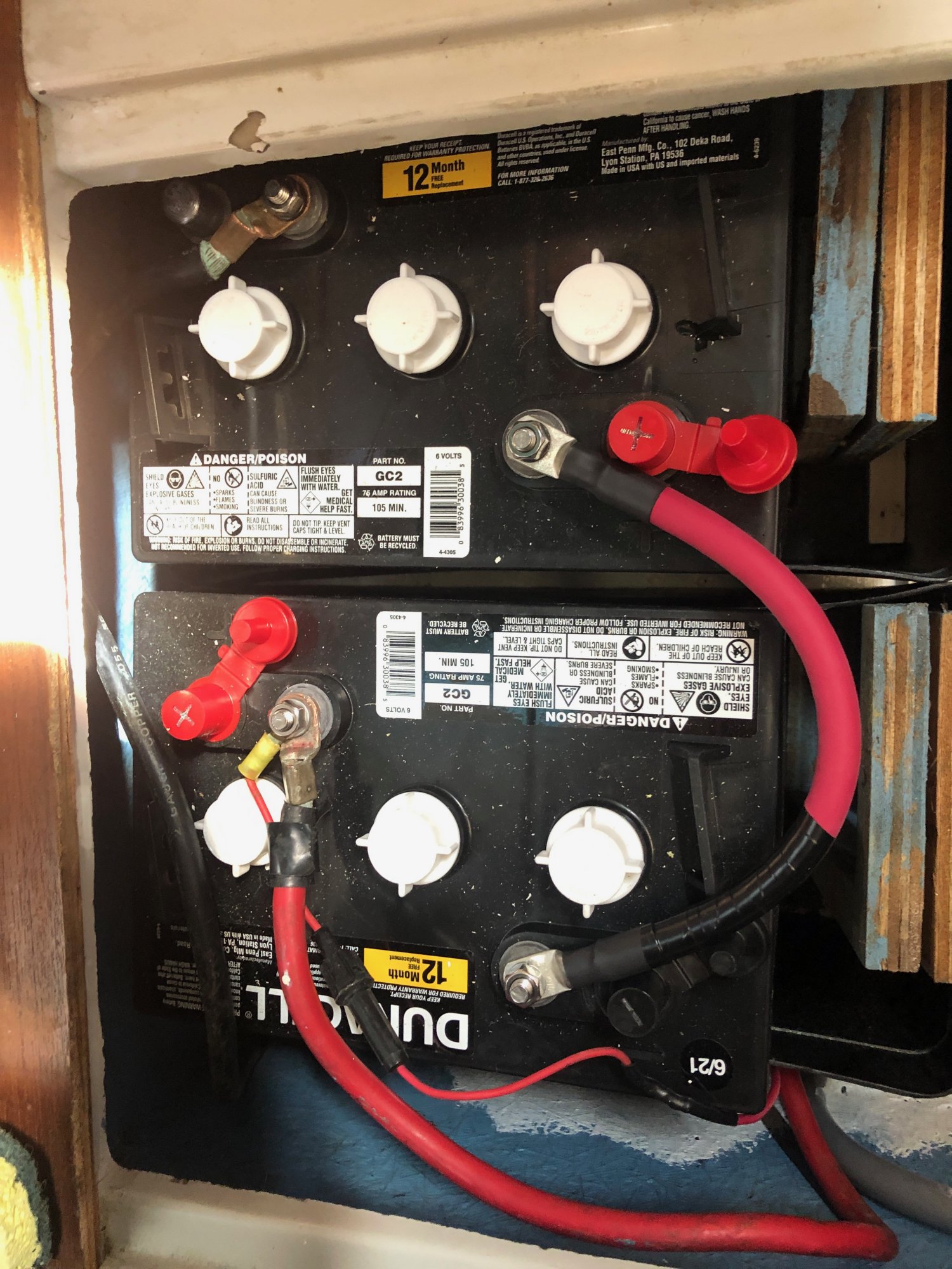

I just replaced 2) 6-year old group 27 marine batteries wired as individual banks on my battery switch. One would drop to 10 volts within an hour of taking it off the charger…the other dropped to 10.5 v. I set up 2) 215 AH 6-volt golf cart batteries as the house bank (Just 215 AH for the bank in series). I am working on a place for a start battery in case I do something stupid and run down the house bank.
But I am also trying to figure out how to charge it…

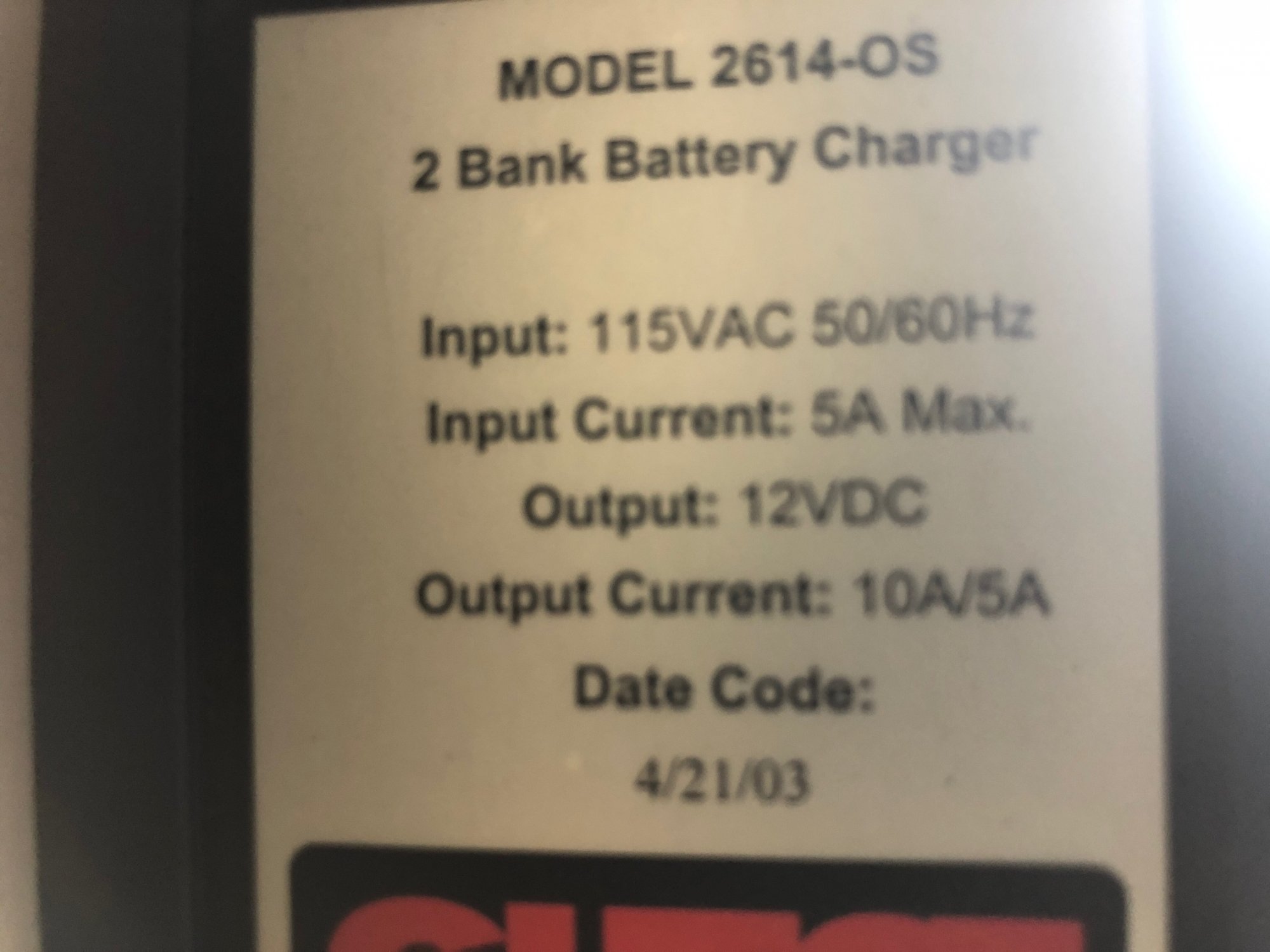

I have an older 2-bank charger. 1) bank charges at 10 amps…the other at 5 amps. I am still tracing to see where these charging wires go….I assume at least 1 goes to the C post on the switch. I suppose 1 could go to the A post and the other to the B post…but do they combine when switch to Both? It is a Guest Model 2614.
There are no wires connected to the batteries except the bilge pump. But there seems to be a lot of stuff on the battery switch…
Always something to learn! The change to 6-volts wasn‘t too hard.
