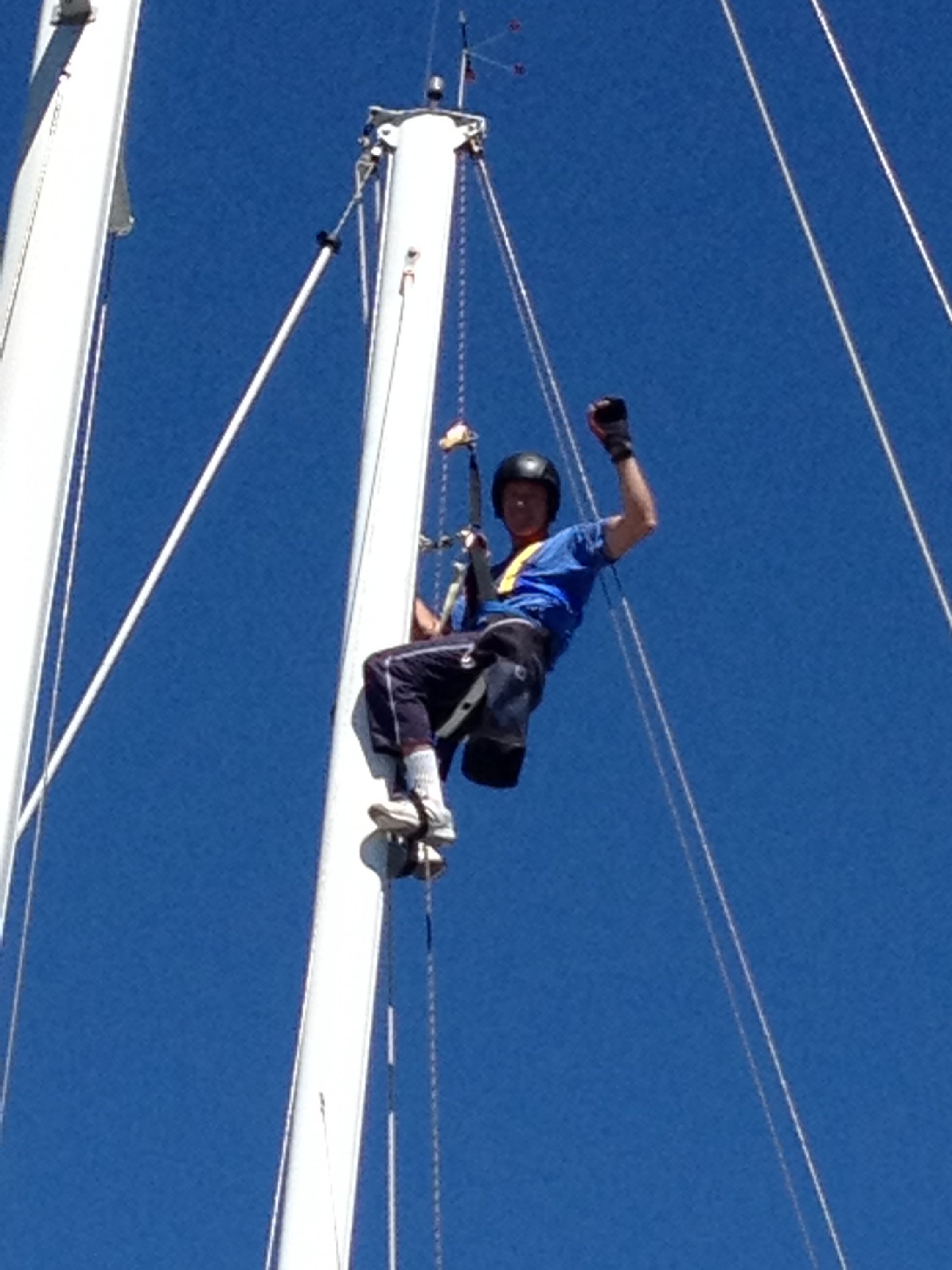

Parsons:
Thanks for the reminder. Also on my mind always. The halyard I will be climbing up is only five years on. Still in good condition. Not chafed. Is a premium line, not the standard "yacht braid" or Sta-set". I use a "mast climber" ascender. As further safety, I rig a second halyard next to the primary climbing line. And wrap a prusik knot around that which I connect by a short line direct to my climbing harness (which I don in addition to the bosun's chair harness). After each "hoist" or "release" with the ascender, I move the prusik knot up or down, then take out slack and re-tension the knot. So if the primary ascender fails, or the climbing halyward, I have a safety backup. I might find myself stuck and need to be rescued. But I shouldn't be able to tumble to the deck. That said, going up the mast never has been my favorite sailing task!
