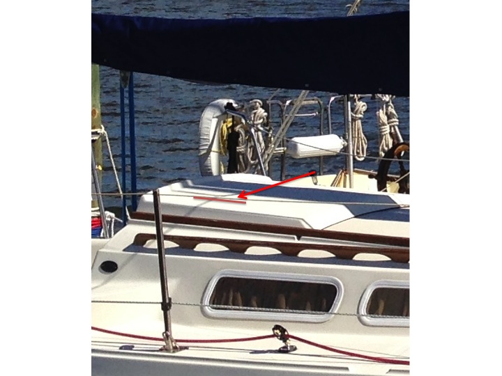

is this a bad location for a single loop hand hold?
We dock bow in and get on the boat via a short finger pier at the bow and walk back on the side decks. The Admiral is always leaning on the sliding hatch while she steps down onto the bench. I was thinking of putting a hand hold where she puts her hands and another one on the other side just to even it out.
I don't normally walk on the hatch so I don't think it will be a trip hazard.
Thoughts?

does that hatch slide forward and aft if so put a 2 loop teak handrail across the rear of it running beam to beam and reinforce it on the underside
it will act like a truss and make the hatch some what stronger

I don't think it's a good idea to attach a grab rail to an object that has the potential of moving just when you need the security of something stable. If there is the possibility that the companionway hatch could slide forward or aft, you might want to consider a fixed location in close proximity.

I think it would work fine, provided your hatch doesn't slide too easily. If your wife can cause it to slide simply by grabbing it for support, then it may not be the best idea.
Guys, you're all missing the issue ... Ward's wife puts her hand on the top of the hatch when she is accessing the cockpit from the dock. She boards the boat probably aft of the shrouds and walks along the deck. placing her hand on the hatch because it is a little taller than the grab rail on the coach roof. She's not walking along the deck while underway (unless in smooth water possibly), she may have difficulty reaching down to the existing grab rail. She's not walking on the hatch.
Ward, if it is not in the way for you, it sounds like a good idea, if just a bit unconventional.

Scott is pretty close as to what is going on.
We enter at the bow between the Life Line Stanchion and Pulpit. She side steps aft using mast, shrouds and boom to hang on to. Just before the cockpit the combing swings in towards the cabin top creating a 5" to 6" spot she needs to step over to put her foot down to the bench seat.
The boom is not completely stationary and she is not very tall so she leans in and puts her hands on the hatch while she steps down.
The hatch has to be closed for her to do this and if there is any pull on the hatch, it is towards the side of the boat or aft and the hatch can not slide any further aft.
The existing hand rails are below knee height and too close to the side deck for her to use for balance.
I agree that a hand rail beam to beam could be an issue if someone needed to grab it because the pull would be fore or after and the hatch could slide but I don't think that is the case here.
I do appreciate all the comments. Gives me chance to make sure I considered all options.

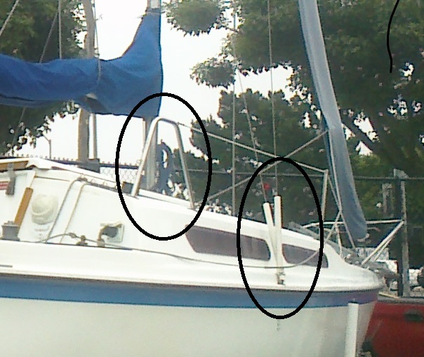

There are also stanchions that might work for you. I had then on the Mac25 and they worked well as had holds. The C27 has a single stanchions pole and people are always using it as a hand hold and as a result it gets bent. I would like to replace that with a similar one.

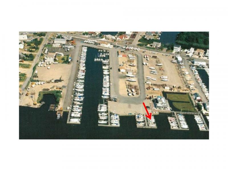

The photo is from the marina's website. prevailing wind is from the south, which is bow on with my slip. The red arrow points to my slip but the photo is a few years old.
