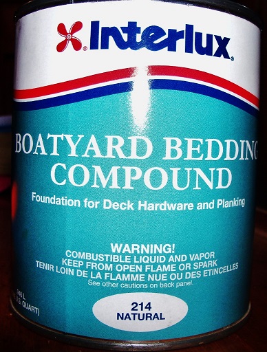

Bedding compound was designed expressly for bedding things on boats. It's cheap, very easy to use and very, very easy to clean up.
5200 is an adhesive, NOT a bedding compound. Beware, it is a very, very good adhesive.
