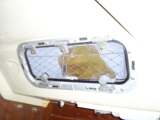

My wife took a pic of the port today. I am sure you have seen these before.

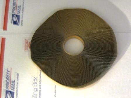

I got it today. I can see why this is better than the windshield butyl. The winshield butyl is a 3/8" round. This stuff is rolled thin and flat, less to squeeze out and clean up, like it was made for bedding things on a boat.;)
