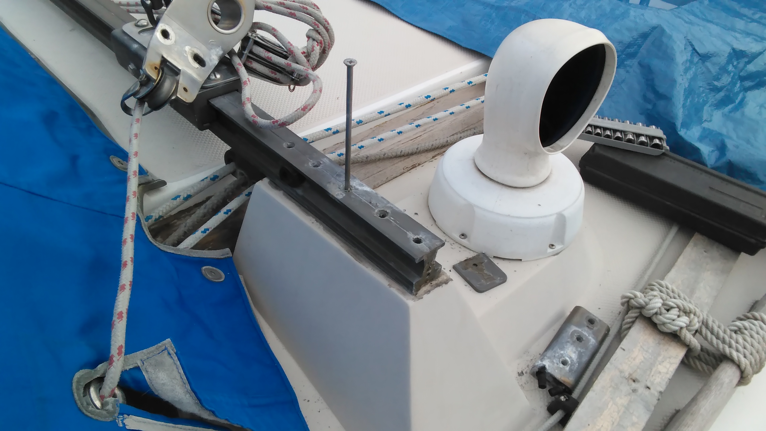

For reference, here is the actual test fit of the inboard genoa track before I painted the decks. FYI, the end cap is an actual stainless 'screw' that is in cured epoxy. The rear end cap is not bedded so the genoa cars can be removed. The curve is very slight, but its enough to require just a bit more than hand pulling due to the lack of effective leverage points.
P.S. I did also check the movement of the car, it does clear the cabin and does not bind anywhere on the curve.

That's a great recommendation, only problem I see is that my track is so close to the cabin walls that the ends of the clamps will likely hit the sides and not allow the nicely curved track to end up matching the holes. I will definitely save this tip
if ever installing a curved track anywhere that such obstacles don't interfere with the clamps.
