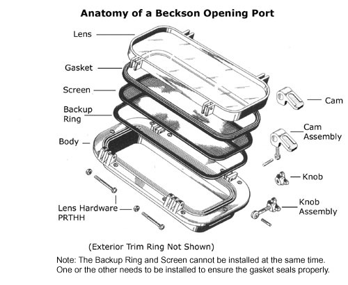

The diagram is interesting. I replaced my 6 opening ports with new ones. They came with screens, and no backup rings. I scratched my head for a sec until I ready the bit that says you only use one or the other (but not both).
