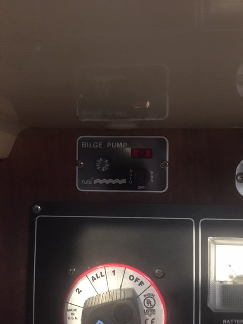

Oh by the way, I finally got to install the auto/manual bilge switch. Do you know they sell the whole unit, provide you with three female connectors, but you have to spend extra to get a fuse.
I have it mounted above my DC distribution panel, but directly powered from the battery.

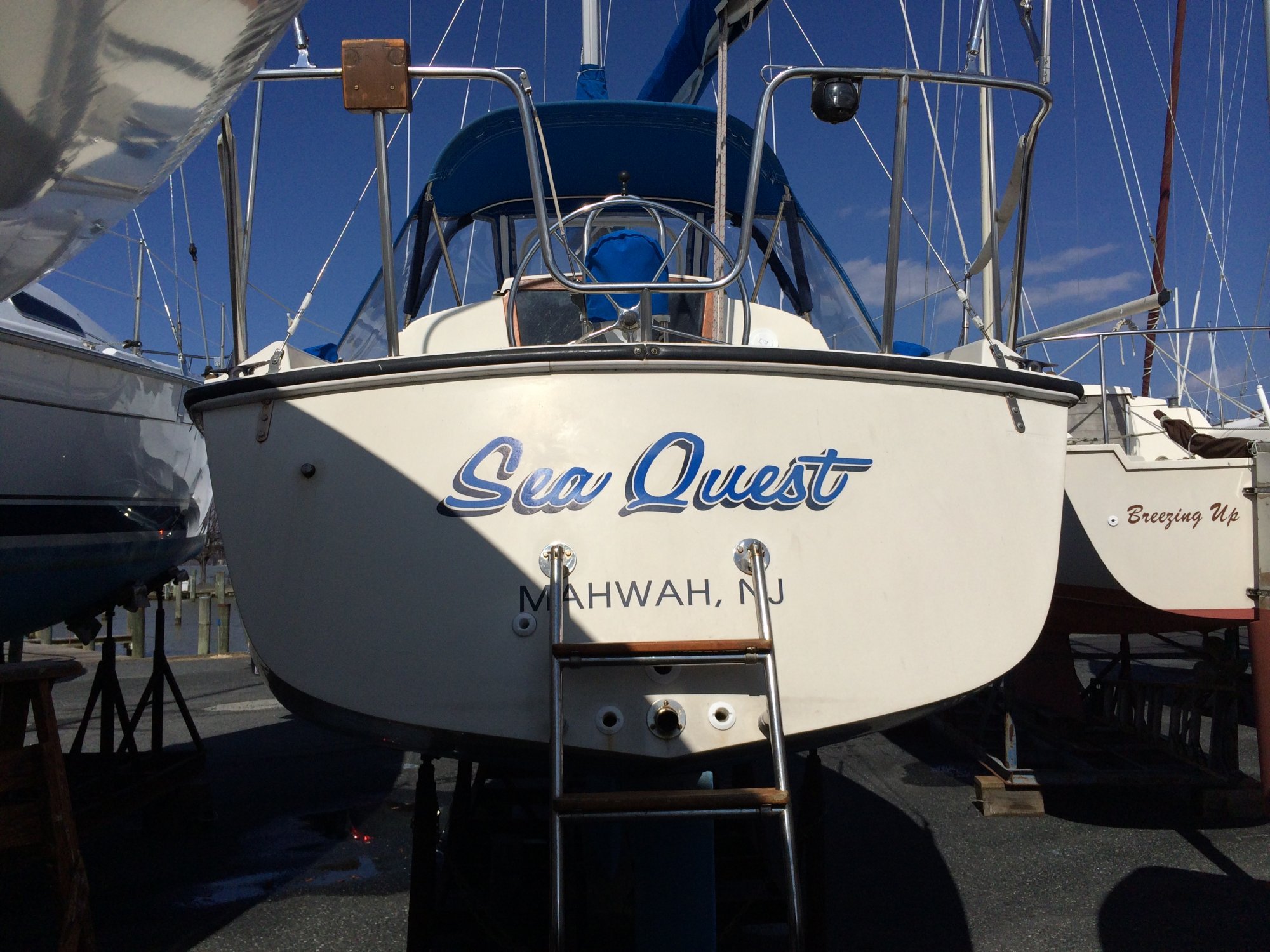

For what it’s worth, the factory installed location for the auto bilge pump output on the Oday 28 was on the transom, port side, about a foot up. It’s the small hole just below the M -
And for the understanding of other readers - the sink thru hull referenced above is a few inches above the waterline, not below as some are.

I'm thinking discharge should be as high up the hull as possible. I installed a secondary back up pump about six inches from the top of the hull. Plus a check valve.
May 17, 2004
6,228
Higher is better for preventing water ingress if the boat is sinking, but until the point where you’re sinking lower is better. Check valves can fail, especially when in dirty bilge water. If the valve fails and the discharge is too high then the same water will cycle back and forth between bilge and hose, eventually draining the battery. Also bilge pumps are quite sensitive to head height. If more than a couple feet of my transom are underwater I figure I’m going to need more serious water extraction ability anyway, so I personally prefer the lower discharge. Your boat your choice as they say I guess.
