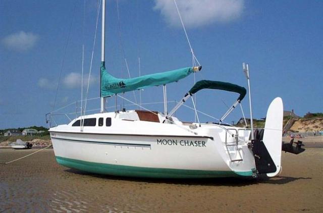

Here's a pic of a H26 at low tide. Don't remember where I got it but it looks pretty happy to me....
