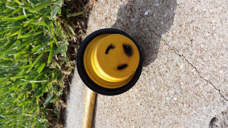

OK...learned a lesson the other day with our 30 amp shore connections. Make sure that they are secure and twisted in or you will have problems. Please see the attached picture. Anyway the question is what should I do. Use it as is, repair it or replace it?
Can they be repaired or can you test them to see if there is internal damage. I really do not want to use it until I am sure it is OK.

Being an electrician for most of my adult life, seen it all. You not only need a new cord set but you most assuredly need to replace the inlet on the boat. Once they have been this overheated, they are no longer serviceable. I had to replace my inlets and cords and they weren't nearly this bad. But like I said, seen it all. Good Luck The click furnished for the the smartplug looks very good. I would go that way if I start to have problems again.

WOW!!! That picture could have come from my camera. I had the exact same thing happen., I not only replaced the cord, but thoroughly checked out the whole ac system onboard. Just to be safe I replaced the inlet. If you love our boat, this is no place to skimp!
