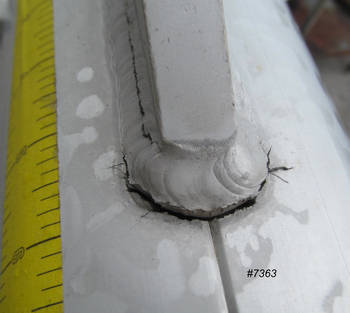

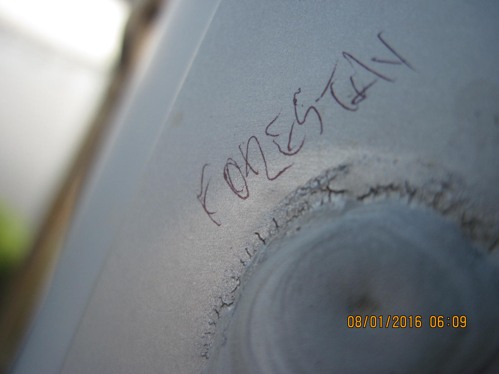

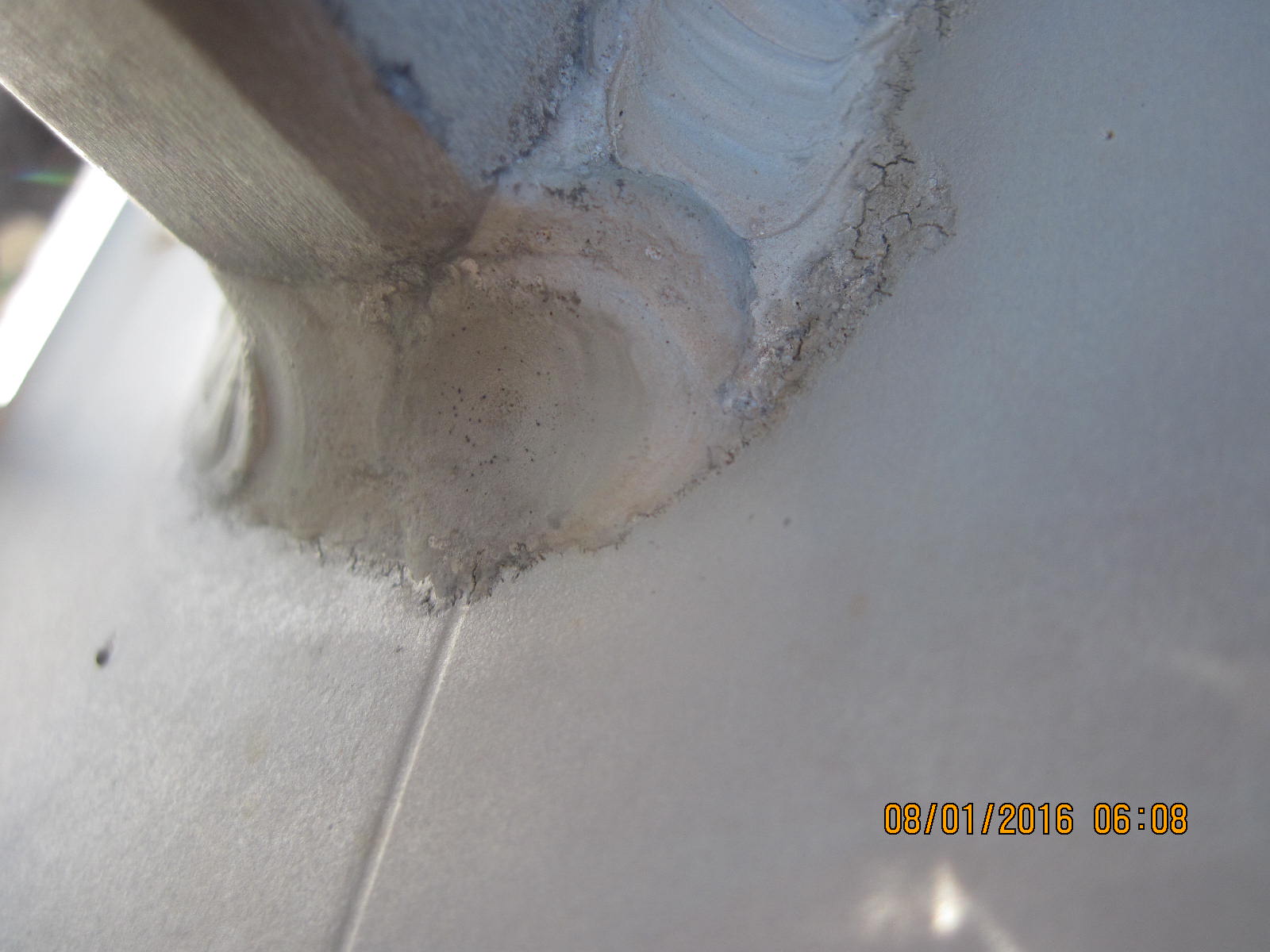

I am seeing an increasing number of aluminum masts on catamarans that have one or more welding problems. This issue centers on pad eyes welded near the mast head for forestay and port & starboard stays. I have seen minor stress cracking from improper weld procedures (too hot) and I have seen catastrophic cracks through the throat of the weld due to improper weld joint design. If you have welded pad eyes it is worthwhile to take a close look at these welds, take photographs and monitor them for change. There is no logic that forgives cracks in welds. Purpose of this post is to announce the observations so that others with same type mast can be aware of this potential problem. If found it would help to hear about it.
