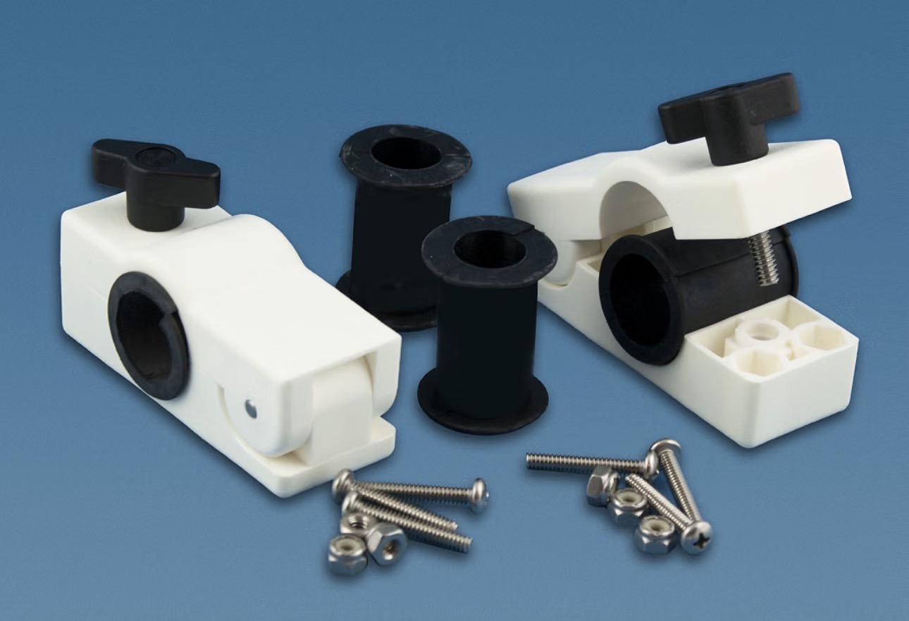

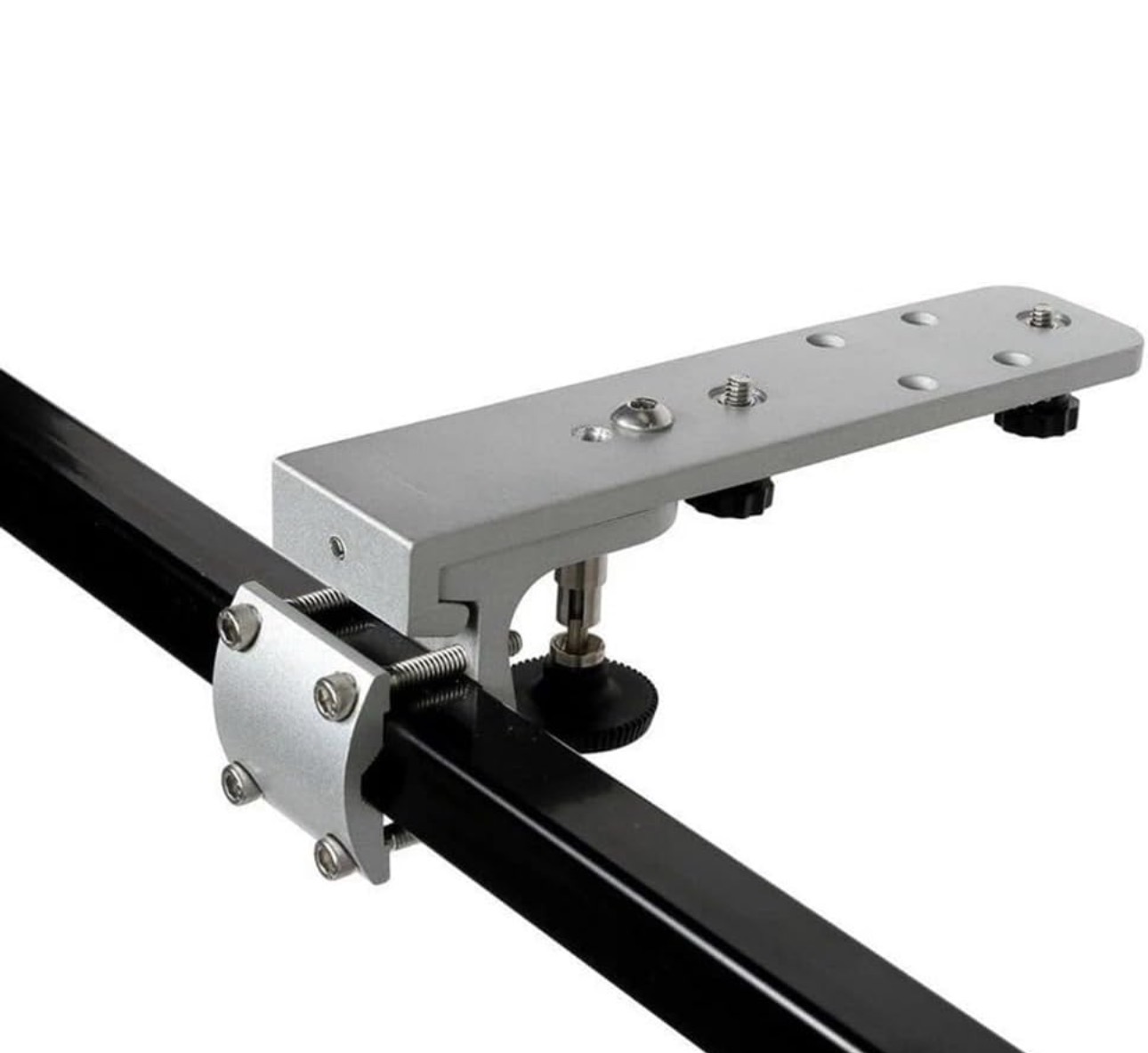

Claw style camera equipment clamps are inexpensive and work well. I've also used mini stage lighing clamps.SeaDog makes plastic rail clamps and of course, you can always take a look at bimini clamps

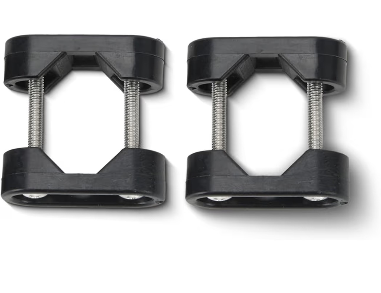

1,360
