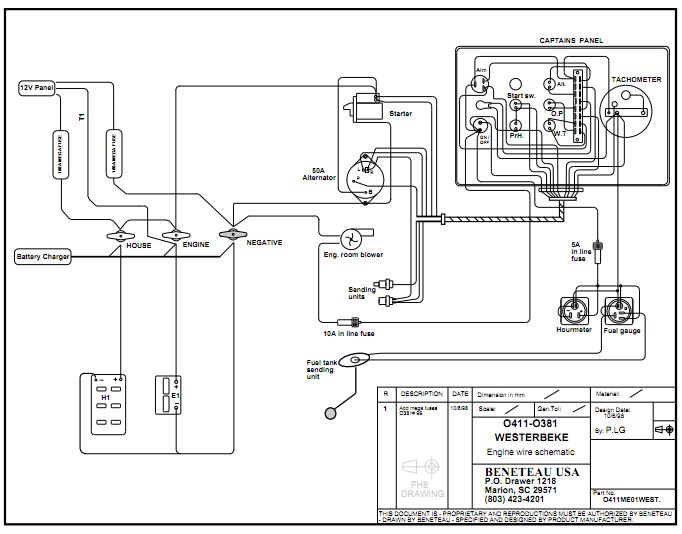

Attached photo is the "basic" Beneteau wiring diagram with the three (2 red one black) switches.
I've looked at your diagrams, very briefly, and find that the "Unknown Connections" are kinda a giveaway about how to approach this issue. If it was my boat, I'd trace the wiring, first and foremost, to understand how it was supposed to work, and then how I want it to work.

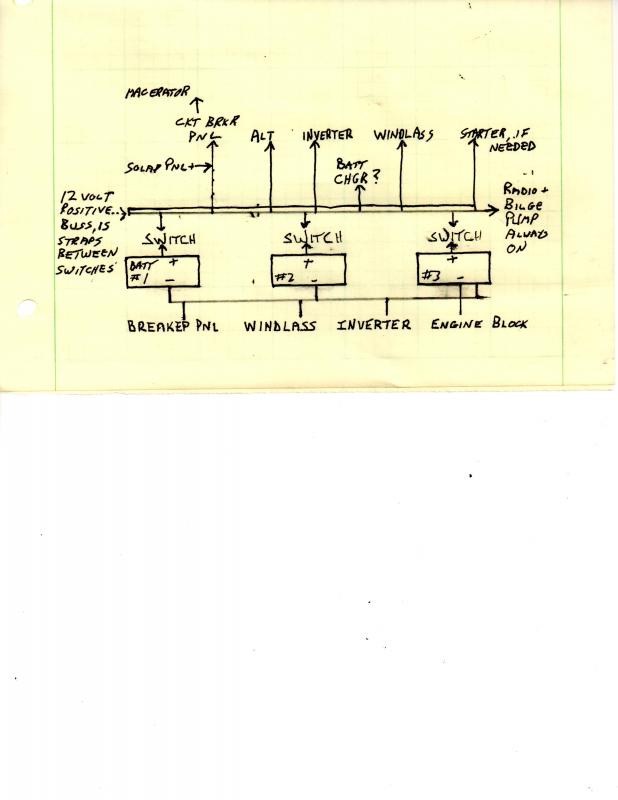

I must say I'm with Stu and the others. Your 3 schematics have unknowns, and we can not totally suggest what to do since we and you don't know what you have - even on your desired 'final'. To assume your boat is similar in equipment to what I have, we B's have a good switch system, though others will think otherwise. I've added alot of equipment in the 8 years I had her, and working off the basic Beneteau design, it has worked very well for me. I just drew up a schematic to the best of my recollection as the details are on the boat.
Your 'final' shows a switch between the radio/bilge, plus a switch on the "motor"- whichever motor you mean. I really have to assume you have a circuit breaker panel that should have the macerator and radio/bilge wired through breakers. Of course there would be an "always on" feed to both of these devices and there should be no switch, just fuses.
You have two batteries, which is what my OEM was, but I added a third- all group 31s. The nice part of this system is you can turn on or off any combination of batteries to use the juice or to recharge them or isolate a bad one. You can switch on either one and read the voltage on the panel meter, but i have a Victron battery monitor for that putpose.
I have a feeling where your "macerator"is, was originally a black one for disconnectiong battery grounds. I had a black one, but rewired it when I added the Victron, then swapped the black for a red for the third battery. (It could have been just painted, and maybe yours is?)
If your batteries are wired as I think they are- or SHOULD be- straight to the switches, the switch would serve the same purpose as the SBH switch you added on your final, and you would not need it.
I would point out it is not possible to charge any battery when it's switch is not connected to the positive buss. Thus far I have not needed to do that, though to do so, I could switch it "on" once the engine has started on some other battery. At anchor overnight or on shore power I always have one battery off line, as "reserve" if you want to call it. With two batteries, I would alternate them as to starting purposes.
ANY of the 2-3 batteries can be used for power, and be charged, when it is switched on. I think this covers it, but maybe more thoughts will become as you pursue your boats wiring system. For clarity, I have not drawn in the necessary fuses. That is another rmatter, but important
