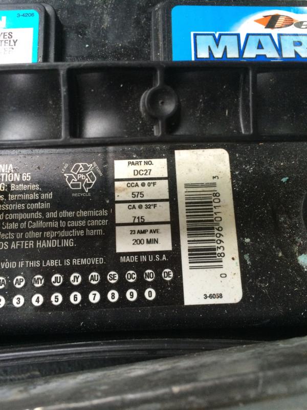

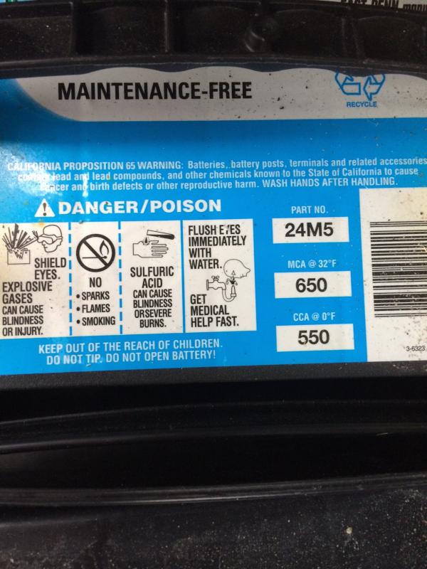

Unfortunately, for the OP, as myself with the same boat, do not have enough height clearance to put Golf cart batteries in the current space where the batteries and charger are located. I ended up going with the 4 Crown Battery group 31's as they had good ah rating and were the same height as the 27's I had there originally.
May 24, 2004
7,228
CC 30 South Florida
Batteries rated in CCA or Cold Crancking Amps are usually starting batteries and not suitable for House use. Make sure you get Deep Cycle batteries. A lot of sailors employ Deep Cycle batteries for starting as the small auxiliary diesels start well with them and can be incorporated into the House bank if needed.
