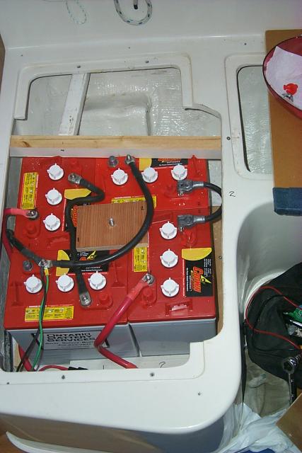

214
Catalina 310 #147 Oakville Yacht Squadron
You may have to take out the board with the fuse mounts and battery connections on it. I actually had to do some cutting on Hull # 147. They had glassed a weight onto the hull, presumably in the tank testing for level and it didnt allow the outer battery to rotate out adequately.
I have replaced them with 4 6V golf cart batteries. More capacity and lighter to manage.
I didn't try rotating the batteries first. Sounds like a good idea! This is the first time I've stored the boat for the winter, and I left the batteries hooked up since I have a solar panel to keep the batteries charged.

My boat (hull #231) doesn't have the fuse holders mounted on the wooden cross member. They're mounted on the cabin sole, next to the batteries, so they're not an issue when changing the batteries.
I like the 6v golf cart batteries. Had every intention of installing them, but my 4D's died while we were at anchor in Cape May, NJ. Had to buy new 4D's from Utche's Marina. Lucked out, though. They were a good price, and the manager and a helper (weightlifter) lifted out the old batteries, and dropped in the new ones for no charge. If you're gonna break down, that's the place to be.
