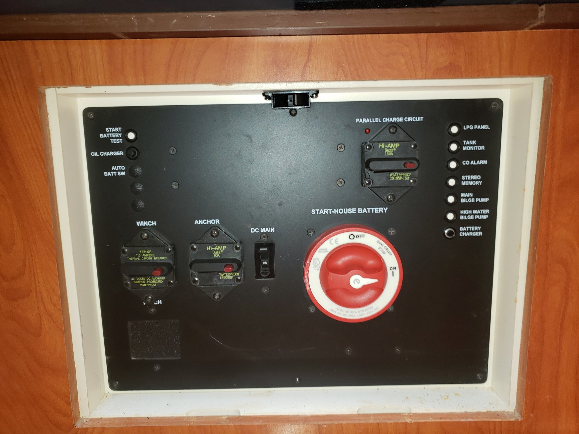

We are having problems with our batteries. Last night we drained all the batteries and couldn't start the boat at anchor. We don't understand how to isolate the start battery so it does not get drained. Here is the panel. Please help.

It doesn't appear as though you have a start battery you can isolate. You would need another battery and a one/two/both/off battery switch to isolate that start battery from your house battery (a single battery?), which appears to be labeled as "start/house" battery. And then you are going to need a charging source for the start battery, so you have a bit of planning to do to get the system you want.

That picture shows a Blue Seas Dual Circuit 5510E switch. It has 4 posts on the back side so it is designed to isolate the house and start batteries. When it is "ON" it switches both banks on but they should be isolated. The difference between this and the DCP is that it doesn't have the capability to combine the banks.
I would take a look at the posts. Is this boat new to you or have you owned it for a long time? If new to you, I suppose it is feasible that a P.O. may have jumped the posts on the back side so that the banks are permanently combined. That would be really dumb and not likely, but who knows until you look?
Other than that, perhaps both battery banks are on just one side. There shouldn't be a reason for both banks to drain simultaneously unless they are linked somehow. I would start at the back of the switch and trace from there.

You have a single pole switch to connect or disconnect the battery bank. I would consider it normal that you only have a single battery bank to perform double duty in starting the engine as well as powering House fixtures. A battery bank may be composed of a single battery or multiple batteries acting in unison. The same way a single cell can bring down a battery a single bad battery could bring down a multi battery bank. Did you run a large load overnight while you were at anchor? How large in Ah is your bank? This sort of thing happens, and that is why you need to build redundancy into your power storage system. A simple way to insure redundancy for engine starting is to carry a fully charged portable power pack like those used for Automobiles. A more refined option would be to have a dedicated and isolated starting battery.

Take a closer look … the switch IS 2 poles and designed for isolation. That said, it may not be used that way. Nick should investigate the back side of the switch.
BTW, the switch does appear to be too simplistic for the application. I'm wondering if there are additional switches behind the scene to give the operator the ability to use one bank to temporarily provide service when the other bank fails. It appears that the single 2-pole switch does not provide any redundancy when needed.
There is switch to the top right ofof the red battery switch. If open it appears to not drain the starter battery. Also does not charge starter battery from the inverter. I am going to start the motor to see if the alternator changes the starter battery when the motor runs.
I think if I open that switch/breaker while at anchor my starter battery will now drain
Three new life line AGM batteries are on there way from Miami. Test showed our deep cell batteries were toasted. The batteries are over two years old and when checked last week they were very dry.

I'm certainly not an expert in these systems but I would try to learn a lot more about your particular system before going down the wrong road with new AGM batteries.
I see the red-light indicator for your "parallel charge circuit" and I see what looks like a red button on a rocker of some kind. I'm not familiar with that at all. I assume what you are saying is that when it is "on" you can charge both batteries from a charger/inverter combo. So this switch appears to be intended to combine the banks just for charging. If you leave it on, the banks are then combined for discharge as well. This is not good at all.
You also seem to want to know that if you leave the switch off, will the start battery charge from the alternator. I can also tell you that you don't want to rely on the alternator for charging the start battery. It may never receive a full charge and you may lead that battery down an early death due to chronic undercharging.
I would think seriously about re-vamping your charging system with a dedicated modern marine charger that charges both battery banks via ACR (auto charge relay). I'm not a fan of inverters and I would probably move away from that charger/inverter combo. I suppose many folks in larger boats like yours are used to having an inverter. I'd probably want it to be a separate unit from the charger. From your description, I'm not even sure you have a charger / inverter combo, but I'm assuming that is what you have based on your description of charging the battery from the inverter. :what::what:
I'd also think about re-vamping your switch. I like Dual Circuit Plus, but I have also added a separate switch for each battery bank (normally always on and hidden in a compartment) so that I can have isolation when it may be necessary to run house and start on just one bank.

What Scott said. You should have 4 wires going to that switch
House battery + and Starter battery + are the inputs and House loads and Starter as the outputs.
This should totally isolate the starter battery from the house.
Now the only question given one alternator is how to charge?
The best answer it seems today is put the alternator to charge the house battery (it is much more heavily used) and then place a ACR (automatic charge relay) between the two batteries. This relay connects the two batteries if the voltage on one of them is over 13.5V and the voltage on the other isn't too low. 13.5V indicates
I stand corrected about the number of poles and capabilities and would need to defer to how it is wired as far as any further comments.
