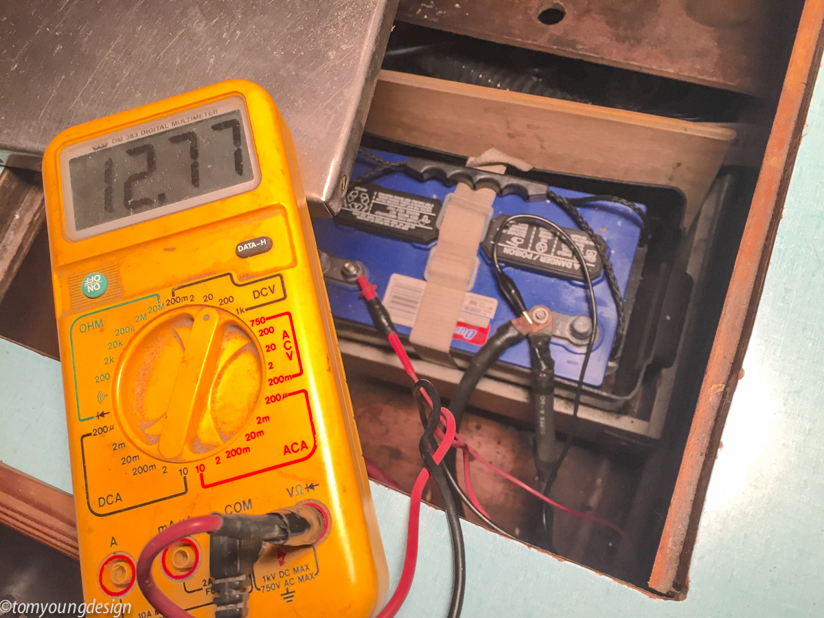

I'm having great luck with a 'dual purpose' deep cycle/starting battery. I may have read they are not true deep cycle? At least 5 seasons old and still going strong and not showing signs of diminished storage. I've never been stranded with a dead starting battery on this boat in 20yrs of use.
This battery is isolated from the house bank except for charging through a dual output alternator(with sense wire on the house bank).
It gets a little more use than just starting. It also powers the anchor windlass. We often sail off anchor so this battery is discharged during retrieval without the engine running.
It's not a back-up for the house but is working great in this starting/windlass position(I think it's a Dura-last brand, from my local marine supply).
