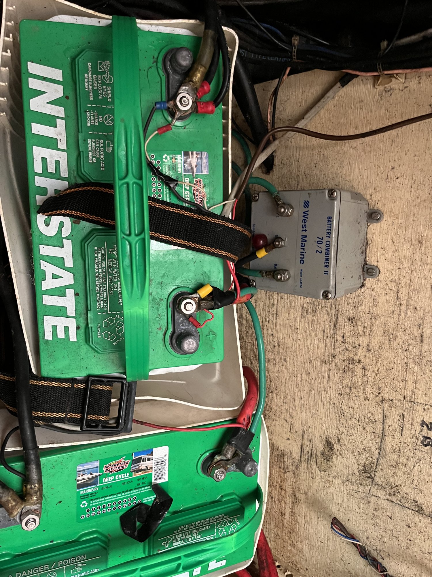

it’s time for me to replace my batteries on my boat. I bought the boat 2 years ago and it has the the batteries that came with it. I have noticed some intermittent shortages in some of my electronics. I figure I’ll get some fresh batteries and start there.
it’s set up with 2 deep cycle batteries connected through a battery combiner (I have a 2 battery switch as well). Is this best practice? Should I have 1 starter and one house and avoid the combiner?

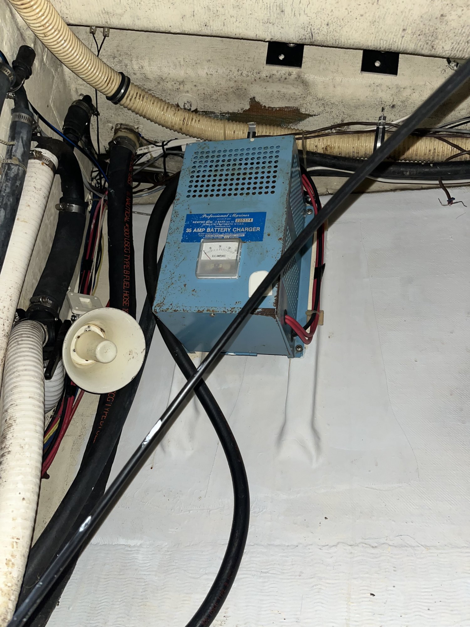

also, my charger looks pretty dated. Do these go bad over time?

The charger you have should be doing time for murdering batteries. It definitely should be replaced. Again there are several options. Likewise, the battery combiner is archaic and should be replaced and there are several options.
The place to start is to consider how you intend to use the boat. Day sailing, weekending, a week cruise in the summer, extended cruising etc. And to consider where the boat is moored, at a dock with shore power or on a mooring. The answer to these questions will determine the parameters of the system upgrade. What's best, depends on how its used.
The battery charger currently installed is not very smart, it just keeps pumping current into the battery until it can't take any more. Modern chargers are 3 stage, Constant Current (Bulk), Constant Voltage (absorption), and Float. A smart charger will extend the battery's life. Victron, MasterVolt, Sterling/ProMariner all make good 3 stage chargers. Oh, and be careful when you remove the old charger, it weighs about 35 lbs. The new one will weigh about 5 lbs.
A battery combiner allows all the charging current to go to one battery. The combiner connects the two batteries when there is a charging current and disconnects when the charging current is not present. This is different from using the Both position on the battery switch because the batteries are not placed in parallel with the charging relay whereas the Both position does put the batteries in parallel. The Blue Sea ACR (Automatic Charging Relay) is a good example. There are other approaches using FETs and Battery to Battery chargers, whether those are appropriate for you intended use, depends on your intended use.

A combiner is now a generic term for a device that allows 2 batteries to be charged from one charging source without being in parallel. In the past they were diode based, which was a poor solution because it dropped the voltage across the combiner leading to poor charging. The most familiar one today is the ACR, Automatic Charging Relay. When there is a charging voltage present, the relay closes and allows the current to charge batteries on both sides of the relay.
ACRs and other combiners are most useful when the start/reserve battery and house battery are isolated from each other. This allows all the charging current to go to the house battery and when the relay closes (or allows current to flow through) to charge the other battery. When there is no charging voltage the batteries are isolated.
In the OPs case with a 1-2-All battery switch the switch can remain in the 1 or 2 position and both batteries will be charged with out the risk of leaving the switch in the ALL position and draining both batteries.

Lose the combiner and make sure my switch is wired properly? Would new charger then go to each battery separately?

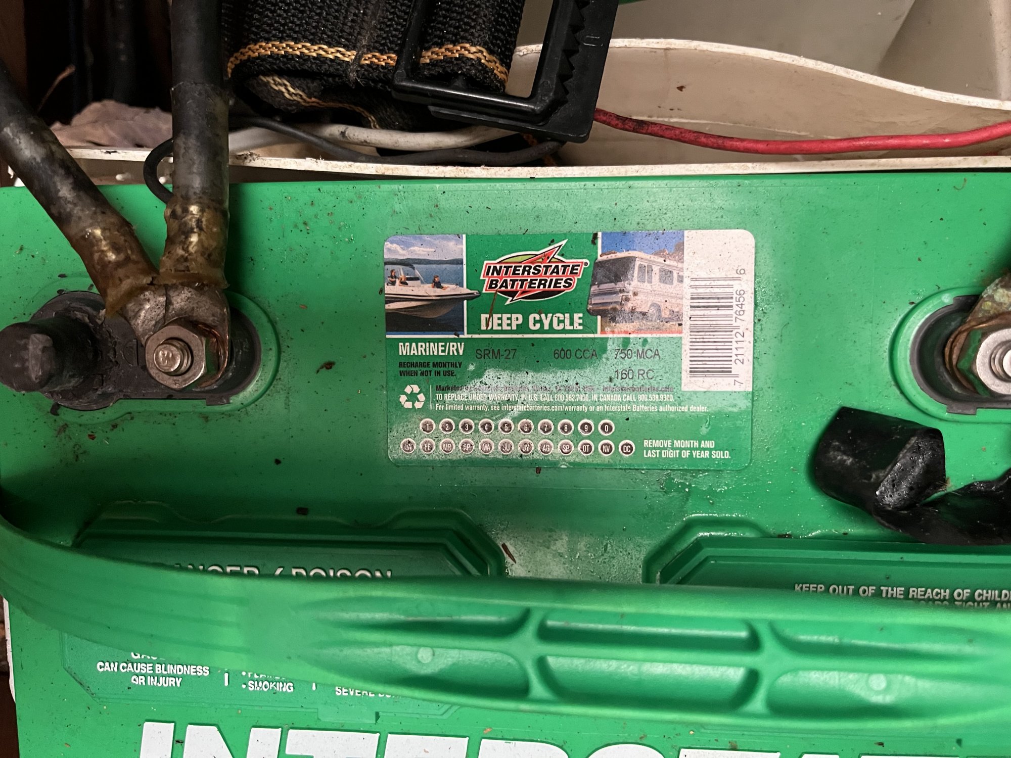

I posted pics of my current batteries, will two more like these to the trick?
Yes. If the battery charger has 2 outputs, then yes you can have each battery on a separate cable. Keeping the 2 Group 27 batteries, you will need a 20 a smart charger.
Your pic showed Interstate batteries, while not aimed at the marine market, I've had very good luck with that specific brand battery. There are others here that know who really makes that battery, but I've forgotten.
FLA's ( flooded lead acid) batteries for how you say you are sailing are a great option.

The Interstate Battery in the photo is made by East Penn. Their batteries are among the better affordable batteries. Their marine line is Deka. East Penn makes batteries for a number of labels, all the same battery, just different colors with different stickers. If the manufacturer isn't on the label, you can tell by looking at the handle and cell caps. If they match the ones you have, most likely they were made by East Penn.
