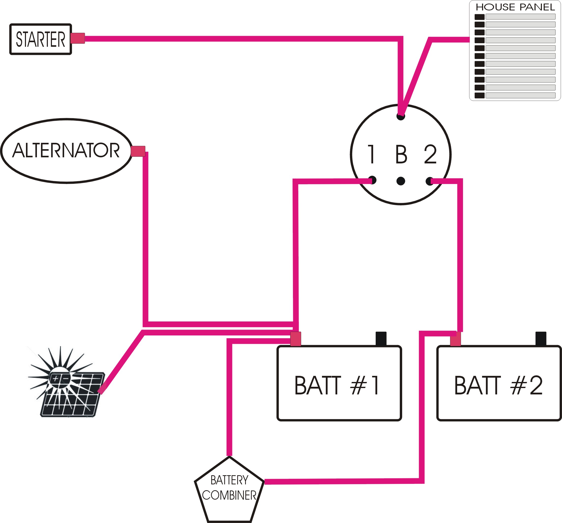

@JohnVTX, do what Stu says... :) Read the info and figure out what you have first.
I re-wired my boat to one of the non-factory recommended ways described in some of the info Stu gave you and now I don't worry about anything anymore (well, not anything, just not my battery charging).
Here's a basic diagram of pretty much what I have now. So, MY switch doesn't matter what position it's in anymore. It's always charging both batteries by the engine or AC charger, and I now use position 1 as the "main" battery and only switch to #2 (reserve) if I drained the first one by accident. I also upgraded my battery wiring to 1/0 size and engine starting is very happy.

jon,
That is a SUPERB wiring diagram. It makes the main basic connections very easy to read. Would you mind if I "pirated" it and included it in my oft-linked battery wiring diagram thread on our C34 website? Of course, I'd use proper attributions. Would you send me the original jpg so I can post it there?

Stu, no need for any credit. If you like it, take it! PM sent too.

Excellent diagram to be sure. Maybe re-label the 'Batt Comb' box because someone thought it was supposed to be a manual combining switch.
