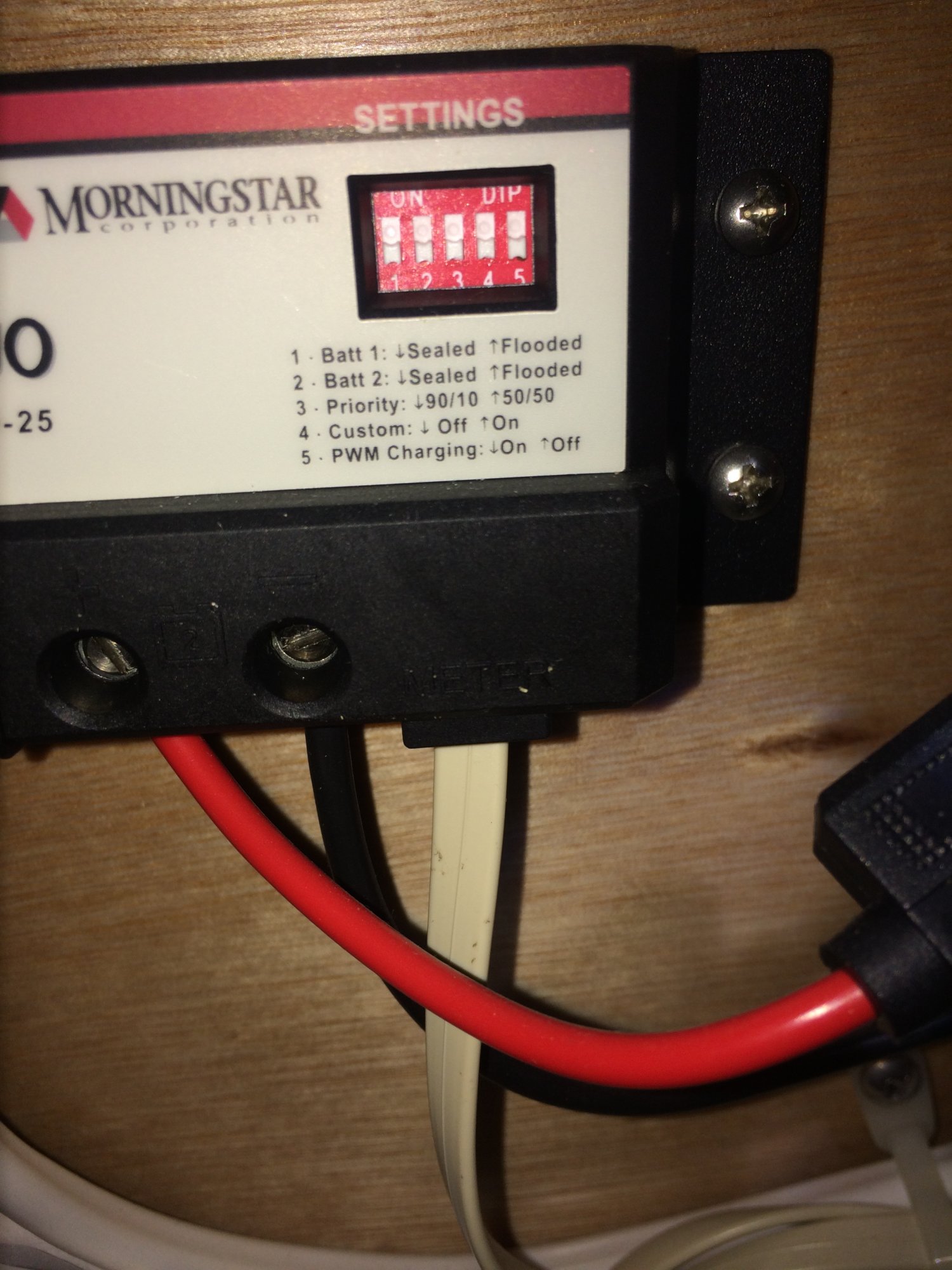

I want to change from sealed/flooded to AGMs. I have three banks. The charger has an AGM setting. How about the alternator? I have an internally controlled alternator. Will it be able to handle AGM or do I have to change the alternator as well?
Also my solar charger controller has a Flooded or Sealed setting which I thought they were the same thing! Can anyone decode? Thanks.

Your image is of a solar battery charge controller. If it is going to be used on an AGM (think sealed) battery, then move the switch down as indicated. If you are using a FloodAcid battery then move the switch up.
Using the described internally regulated alternator will charge the AGM battery, but the method will not be optimum for the battery. This is the reason external regulators have been developed that better manage the alternator charging performance

Once you decide that AGMs are the best choice for your sailing and cruising life, then contact the manufacturer and ask for the proper charging protocol for your batteries. Generic settings may be OK or may not, best to go with the manufacturer's recommendation. The gold standard for battery documentation has to be the Lifeline AGM documentation. It will be on their site.
The stock internally regulated alternator that presumably have on your motor will most likely be unable to properly charge the batteries. It is probably not set up to properly charge basic flooded lead acid batteries because the charging voltage is too low. The settings can not be changed or changed easily.
The Solar controller will not adequately charge AGM batteries and will need to be replaced. A sealed battery and an AGM are different critters. Sealed batteries aren't really sealed, they have a valve that will release excess pressure.
Without knowing more about the charger, particularly the capacity of the charger (how many amps) and the charging profiles it is not possible advise on the charger.
AGMs are finicky batteries, they have some advantages but are easily trashed. If you have been shopping for them you know how expensive they are.
