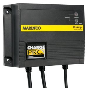

Check it on Amazon at $120.34. It is a 5/5 for two batteries. Its marine grade and waterproof. That is the best value for the money. It retails at WM for $150+. If you have a standard two wet cell battery system, do not discharge your batteries very deeply and spend some time hooked to shorepower between outings this will work nicely for you. Like anything electronic, it could last 20 years or fail tomorrow but these units are pretty reliable.

View attachment 121084Check it on Amazon at $120.34. It is a 5/5 for two batteries. Its marine grade and waterproof. That is the best value for the money. It retails at WM for $150+. If you have a standard two wet cell battery system, do not discharge your batteries very deeply and spend some time hooked to shorepower between outings this will work nicely for you. Like anything electronic, it could last 20 years or fail tomorrow but these units are pretty reliable.
That's the unit that, apparently, refuses to charge batteries it deems to be "bad." It's not clear what makes them "bad" as many people reported that "bad" batteries remain serviceable for years...
