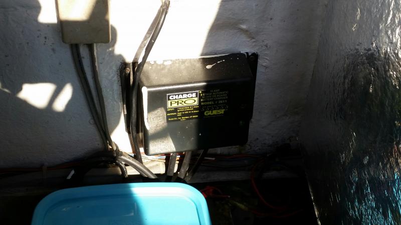

On my 1985 Oday 28, the current charger resides, mounted on the forward wall of the port lazarette, next to the water heater. It is an 18 year old Guest Model 2611,,,10 amp 2 -output, which I don't believe is designed for my newer Group 29 batteries.

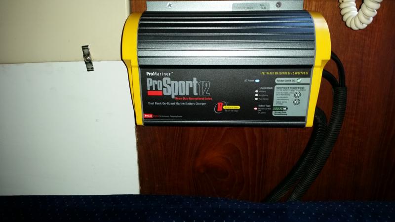

DONE, a GREAT spot to mount it,,, starboard side of the engine compartment, forward of the battery access panel, less than a foot to Battery #1,,,
I figure, any opportunity to replace an 18 year piece of electronics,, that was poorly located, for not a ton of money, I'm in!!!
Images of OLD and NEW!!!

I've got my eye on that spot on my boat as well. Do you guys think it is out of the weather enough? Does it interfere with access to the quarterberth i.e. is it susceptible to damage when you chuck stuff in there for storage :>)
Coyote
Sep 30, 2008
132
Hunter 30T Madeira Beach, Florida
as far as I can see, weather a non-issue,,, plus the Charger is waterproof,,
I NEED to be careful when I lift the quarter berth cushion to access the storage beneath, which for me is rare, and when I need to access the battery panel to do my monthly battery check and maintenance, and again this is a non-issue,,
