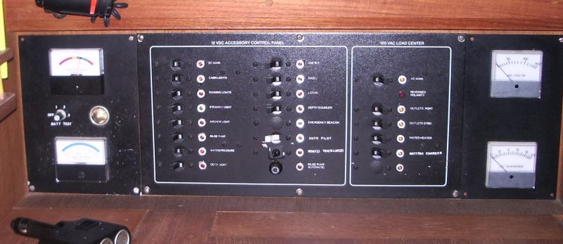

H-34 Batt Charger
Boat did not come with a battery charger so that is a dealer or previous owner modification. My previous owner or dealer installed mine on a dedicated breaker on the AC panel. Attached picture of panel. The breaker that is second from bottom is the battery charger and the bottom most one is the air conditioner.
They are labeled now..

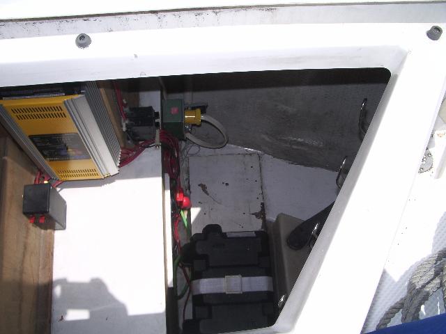

Hi Markwbird,
Same as the others, I ran a fresh wire from the electrical panel and installed a new circuit breaker in one of the empty spots. You can see the box I put in down in the basement next to the original battery location. I used rub on letters to identify it.
P.S. Did you get the PM I sent you on this site a couple of weeks ago? I was in your neighborhood.
