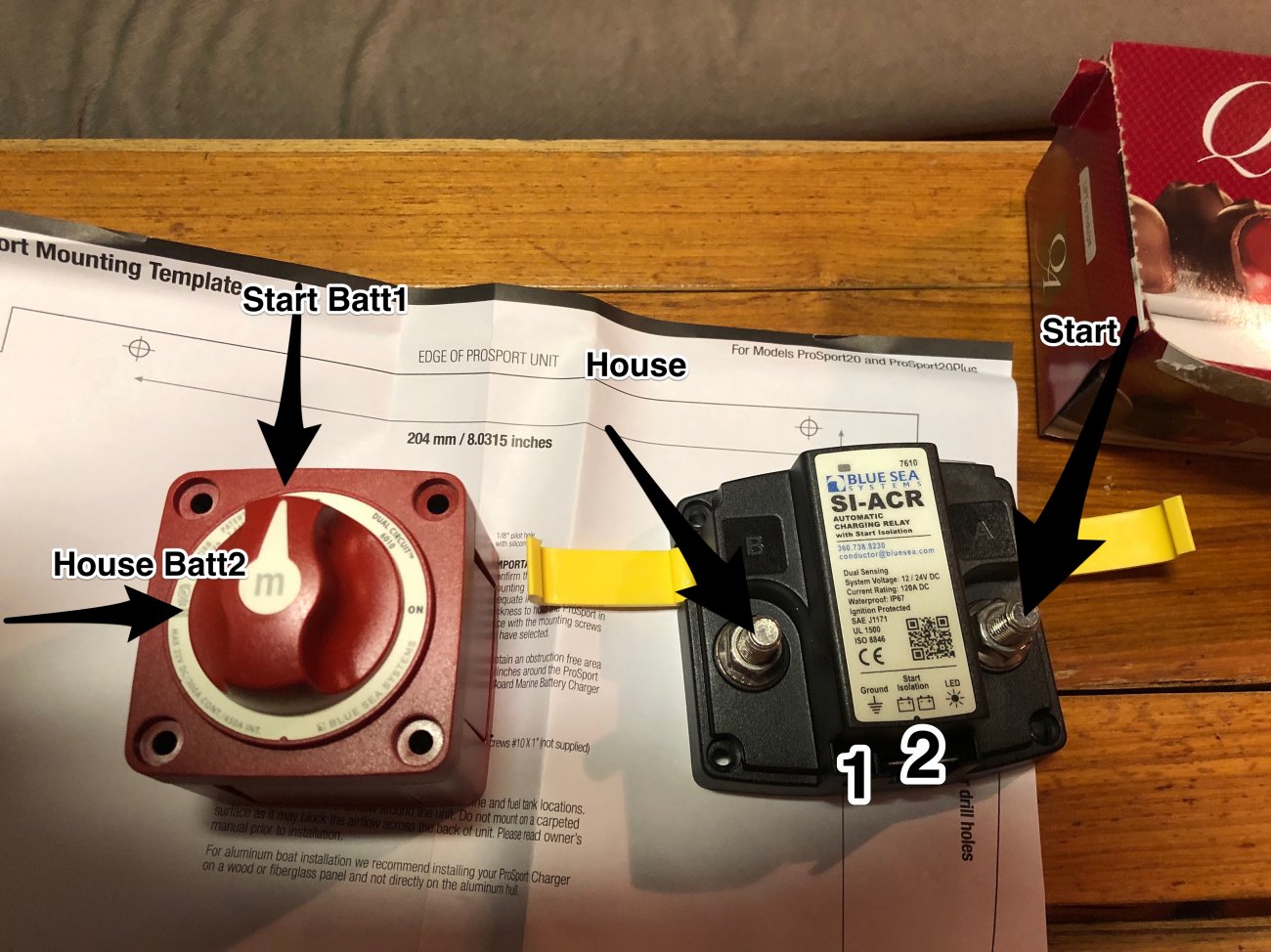

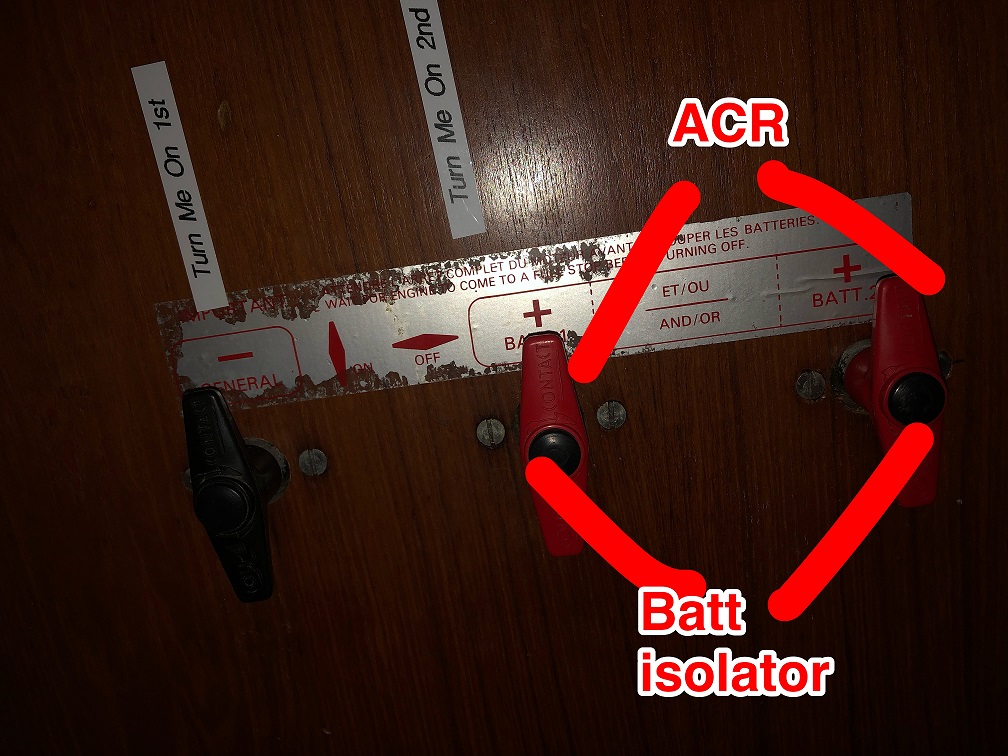

Thank you so much @jssailem for the email and the post! I couldn’t figure that out last night. And @Davidasailor26 mainesail updated the drawing on post 11 on this forum. I’m doing that for the most part without the solar. Today’s project is the battery charger, the emergency parallel, and the ACR. When you look at a picture it all makes sense because mainesail is an electrical genius. Then I look at the pic and compare it to my actual system, and it gets a little less clear. I just wanted to make sure I had it right. I am going to leave the negative switch for a potential (more like possible) third house battery in the future. Or more likely an always hot panel for things like the bilge. That is why I’m installing an emergency parallel switch. I understand the concept and am positive I can wire it. Mostly just need someone to take a second look see.
Pic 2 is my basic plan. I haven’t actually measured and cut the wires yet so the actual placement may change a bit.
Pic 1 is how I plan to wire the two devices. There is an A and B side with B going to the house. The #2 is the starter isolation.
I plan on using all #4AWG for the wiring except the starter isolation where I plan to use #16AWG.

I presume that on the Blue Sea switch your inputs will be on the 1 and 2 side? Where will your outputs from that switch go, to the respective start / house circuits? If so, it looks sound to me, although you won't have an emergency cross-over capability for the two banks, unless I'm just not thinking through it enough to see how.

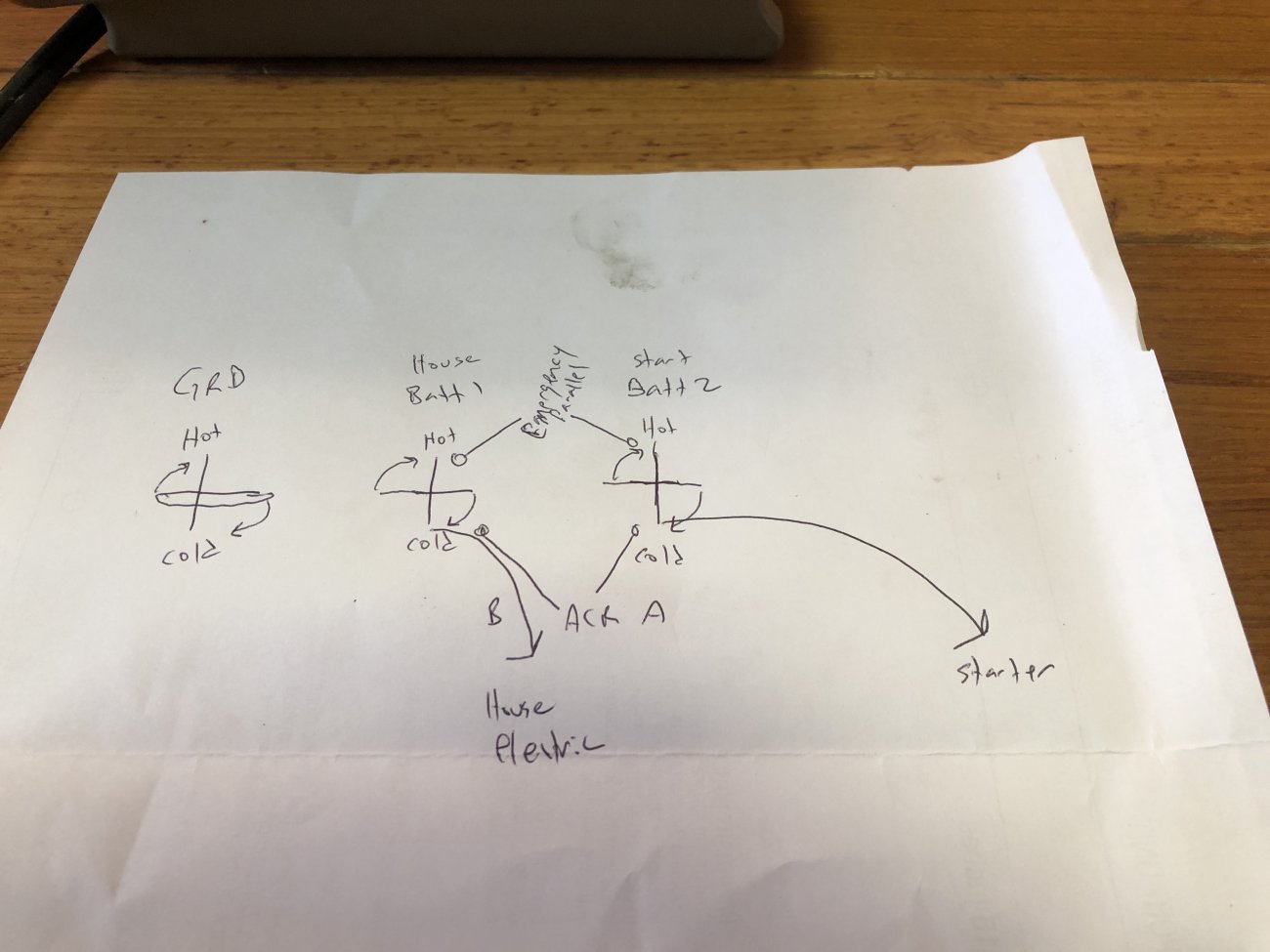

Ok one more thing... wire the ACR to the cold side and the emergency parallel to the hot side? The plus is the battery switches.
Take a look at the pic I just posted. The numbers aren’t the same as the original pic. I had to change some stuff around. The most recent pic is the (most?) correct one.

Actually I think I liked it better the other way - with the ACR on the hot side and emergency parrallel on the switched side. That was is more like Maine's picture. Benefit is that if the start battery internally shorts you can switch it off, then use the emergency switch to send power to the starter from the house. If the crossover is on the hot side then you can put the batteries in parrallel but you can't take one bank completely out and use the other.
My bigger concern is that I don't see how the Blue Sea 6010 can serve as an emergency parrallel switch. As far as I can tell the 6011 has a "combine" position, but the 6010 doesn't.
That's correct. There are 2 very similar switches, one allows the batteries to be combined the other just turns them both on or off. The one you want is 5111, Dual Circuit Plus.

I can't find a 5111 in Google. I'm thinking just an on/off switch would work on the cold side of the main switches. Off for normal use, on for combine/cross-over. In a Beneteau adding a ground bus bar and repurposing the ground switch works for this purpose, although it doesn't leave the future expandability flexibility Juice talked about wanting.

Yeah you are correct, i was looking at everything and I went back to the store and got the 5511e.

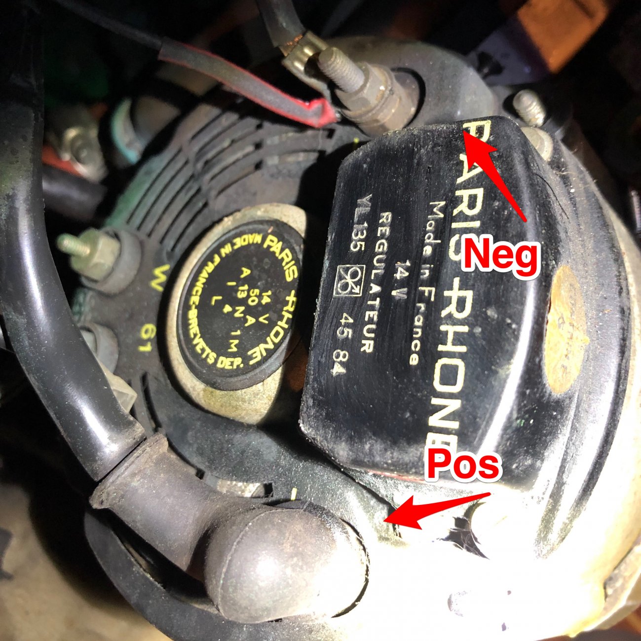

Ok, on the final stretch of this project and I have a couple more issues. Than I can let it go and I’ll move onto something else...
1. For some reason the positive from the alternator runs to the positive on the starter which I have run to the start battery switch. Shouldn’t this run this to the house batteries? That way I don’t accidentally kill the alternator and it charges the house batteries first.
2. The directions show the start isolation wired to the “run” spot on the key switch. Maine sail’s picture has it run to the alternator. Which is the correct spot and how important is this? The directions show it as optional.

Lot of what looks like belt dust on the alternator. (Not good stuff to breath)
Check your belt alignment and tensions.
Or it may just be good Alaska Dust... Still I would clean it off of the alternator. A clean alternator is a cool running alternator...
Yes. Engine manufacturers ship their engine with this set up for a couple of reasons. It is cheaper for the boat builder to install the engine by running one cable to the starter for both the alternator and starter, than 2 cables and if the alternator is connected to the starter there will be a connection to the battery and load which will prevent blown alternators and warranty claims.
This wire takes the ACR offline while the engine is starting. Starting the engine creates a large short amperage draw that can mess things up. If you look closely, I believe the directions are to attach it to something that will receive power only when the starter is engaged. The high amperage draw can drop the system voltage which may or may not cause some electronics to gag and need to be restarted. This wire is not essential.
Short answer is Yes as jssailem and dlochner said. See Maine's post in #14 of this thread for the details.
I think Maine's picture has it going to the start button if I'm reading it right. That would make sense - you want that input powered when the starter is running as dlochner said.
