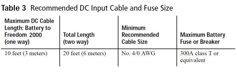

Due to the way inverters work wire sizing should follow manufacturer guidance as the units can draw upwards of double their nominal rating for as much as 30+ seconds and for a 2000W Freedom they are capable of 4500W for 15 seconds or so. The original Freedom 20's (2000W) came with a pair of short black battery cables pre-fixed to the unit and the maximum they could be extended was to a 20' total circuit length. Lengthening was actually not recommended at all but they recognized this sometimes had to be done.. They used to recommend 2/0 for this but over the years all inverter makers have learned something things and they have since increased recommended wire gauges. This is from a Xantrex training document I have. This is for a 2000W inverter with total circuit length of 20'..
