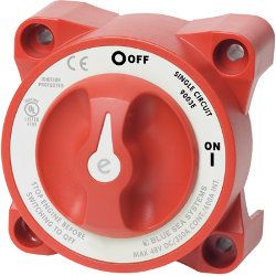

Instead of using studs for a service disconnect switch, why not put these in its place? It will work as designed and might even look like it was intentionally designed that way.
14,168
:plus: The one issue I have had with the Blue Sea Switches is the mounting. It is necessary to remove the entire switch to access the mounting studs. Marinco (Blue Seas parent company) has a Pro series of switches which can be surface mounted and the switch part comes off leaving the base and studs attached to the bulkhead.
