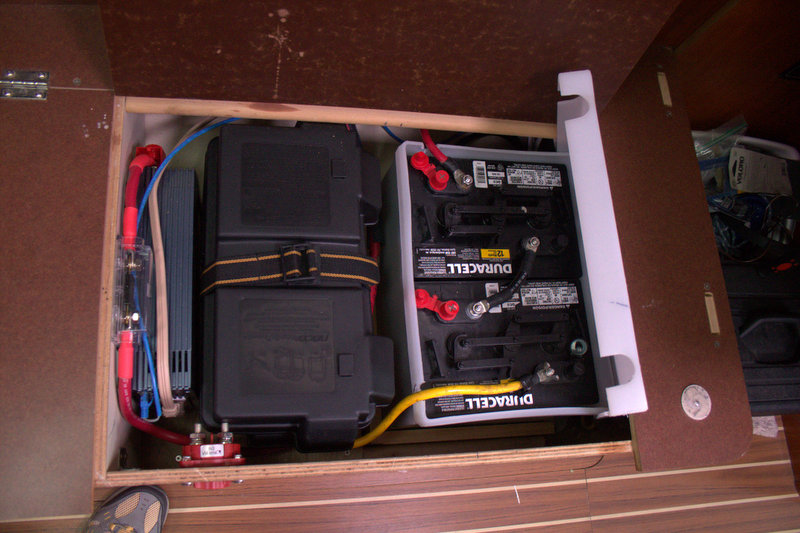

Jun 28, 2005
440
Hunter H33 2004 Mumford Cove,CT & Block Island
Batteries are going under the starboard settee. I have the footprint to fit box bottoms, but only have 11 1/2" height. Trojan T105's are 10 7/8" height, so wouldn't have room for box lids.
I removed plywood bottom and replaced the forward half where I have a Walmart 29 mounted, on the aft half I fabricated a base for a dual 6 v battery case which I trimmed shorter to fit batteries, The batteries are the 6 volt 220ah from Sam's. The base was fabricated from plywood and 3x1's and sits deeper in the well. Everything is removable easily.
Also pictured is 1500w inverter, Fuse and its Battery switch.
