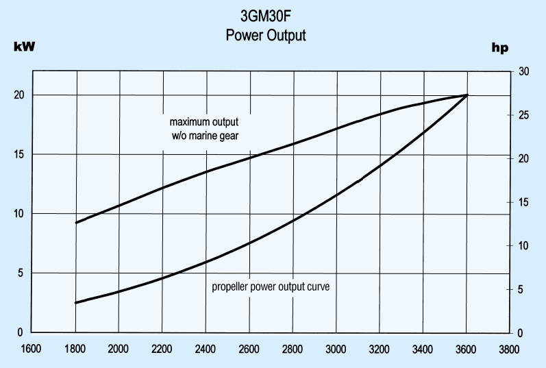

I'm curious, at one-tenth the rated power, you can get 2.5 to 3 knots of speed, or about half the hull speed? That seems low to me. My Yanmar needs closer to half the rated power to achieve the same speed.
I could do easily 3-4 knots at less than 2000 rpm with a 33' boat and a 3GM30. 1800rpm is about 2.5kw of power from the Yanmar, thats half the rated RPM, but about 12.5% of the power.
