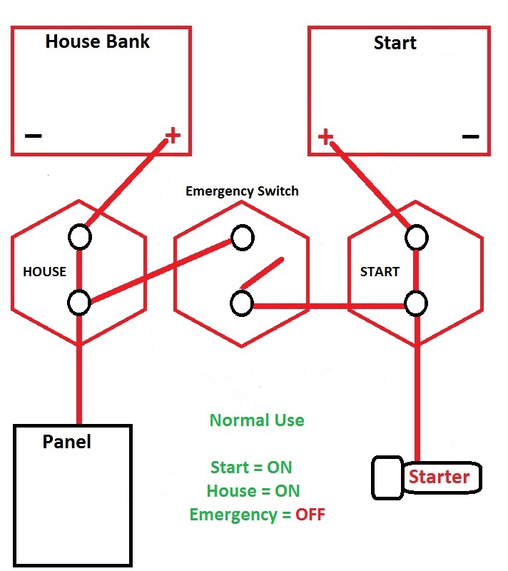

In the attached diagram, what is labeled "Emergency Switch" is what my question is about.
The emergency switch in my boat is made by albright. The triggering contacts lead into the engine harness so I can't tell what should trigger the switch.
-Is the switch supposed to be open normally?
-And if not, what is supposed to trigger it?
And I understand your point about you not being able to answer directly. The boat is a 2007 model and I've tried to trace the wires to figure out how it should work, but I'm getting stuck where the wires enter the engine.

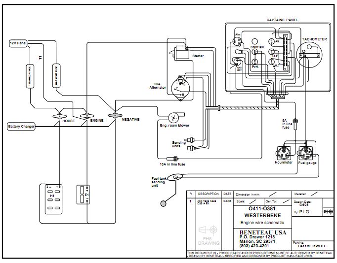

Here's one of their wiring diagrams:

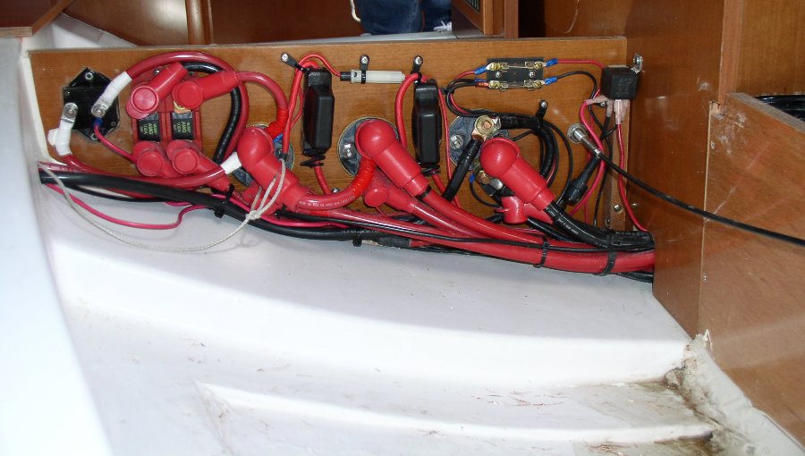

Post 7: check to see if there is a cable between the 2 load sides of the battery SWITCHES (added). Any/both batteries switched on will start the engine. This pix is/was Chuck's 323. The suspect missing jumper on your boat has the string around it. Did you buy this boat new, or used? SOME people take that strap off, but I'm not gonna say why, because I don't agree with it. IIRC, that heavy cable on the top of the middle switch goes to the starter.

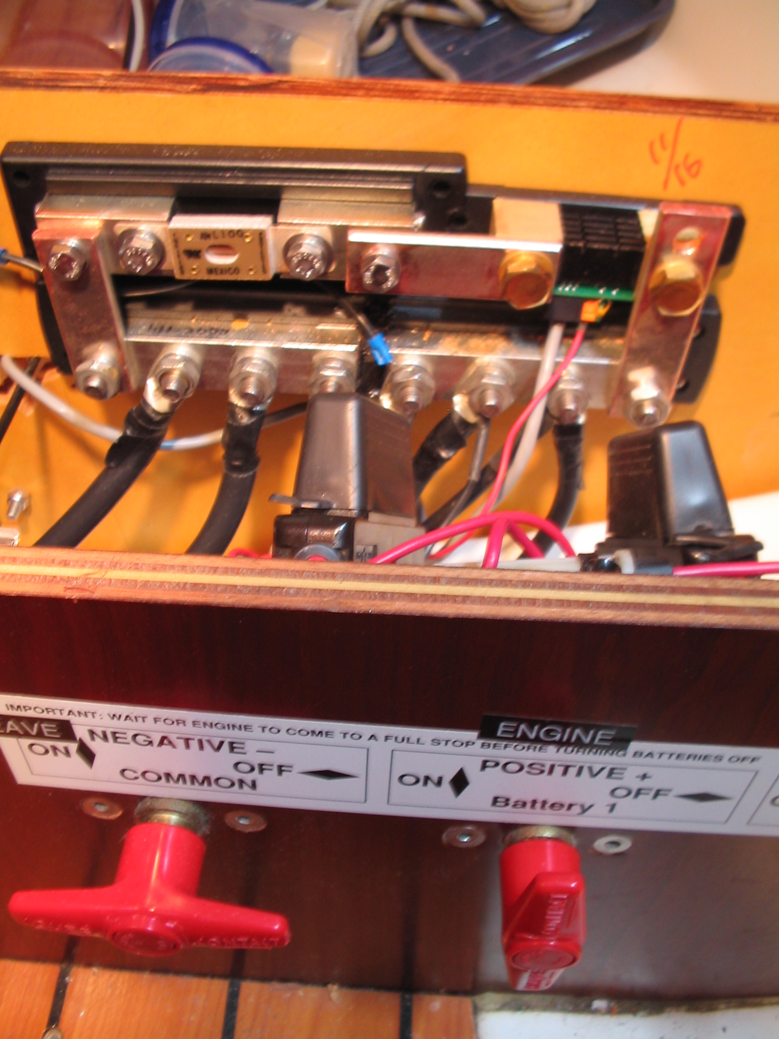

By the way B guys, you can easily cut a new little panel to protect the back of the switches. On the aft side of the stringer in my BATT pic, cut a cardboard template to match the hull, then add the vertical side to your pattern. A 1 x 1 or larger vertical cleat about on that seam in the wood partition on the right. You could glue the bottom of the new panel, but mine stays put with just being screwed to the cleat. Here is a pic of my panel t=with ground cable and Victron monitor wiring.
