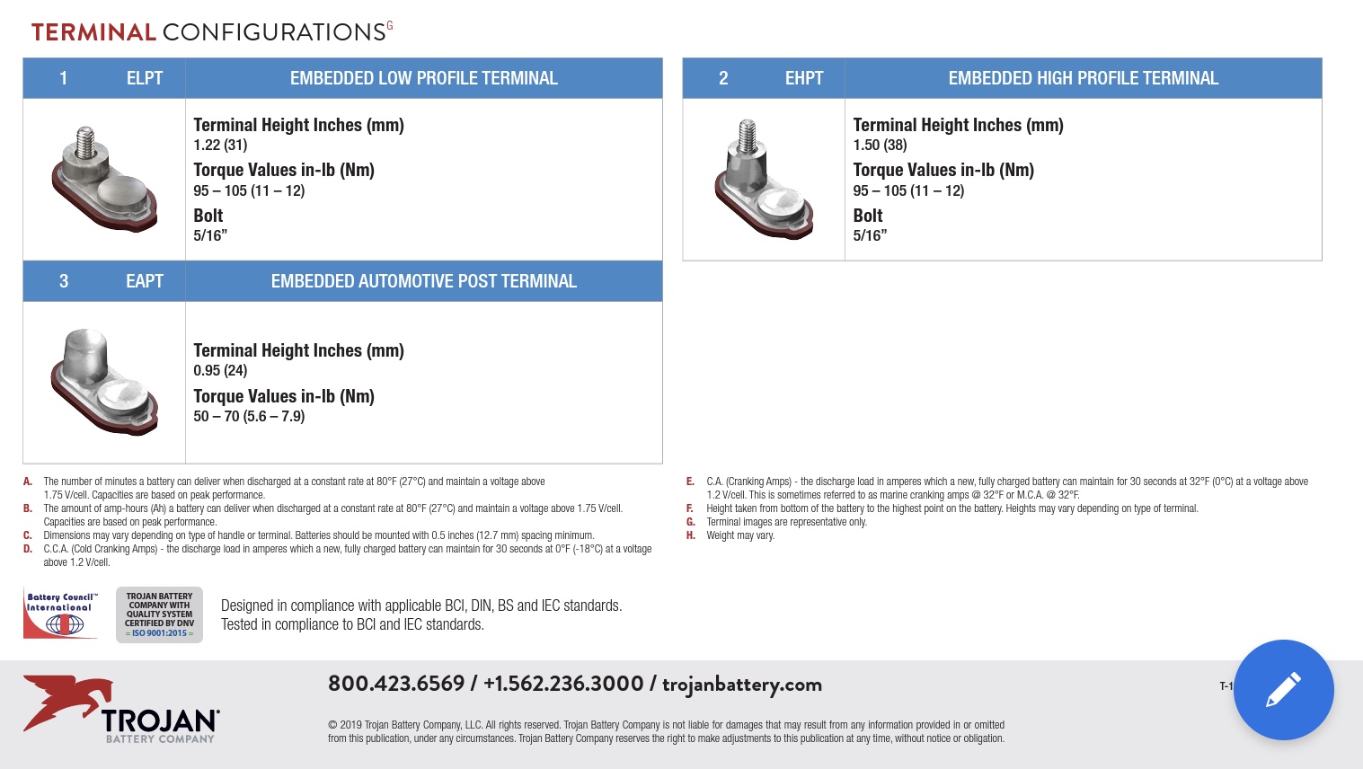

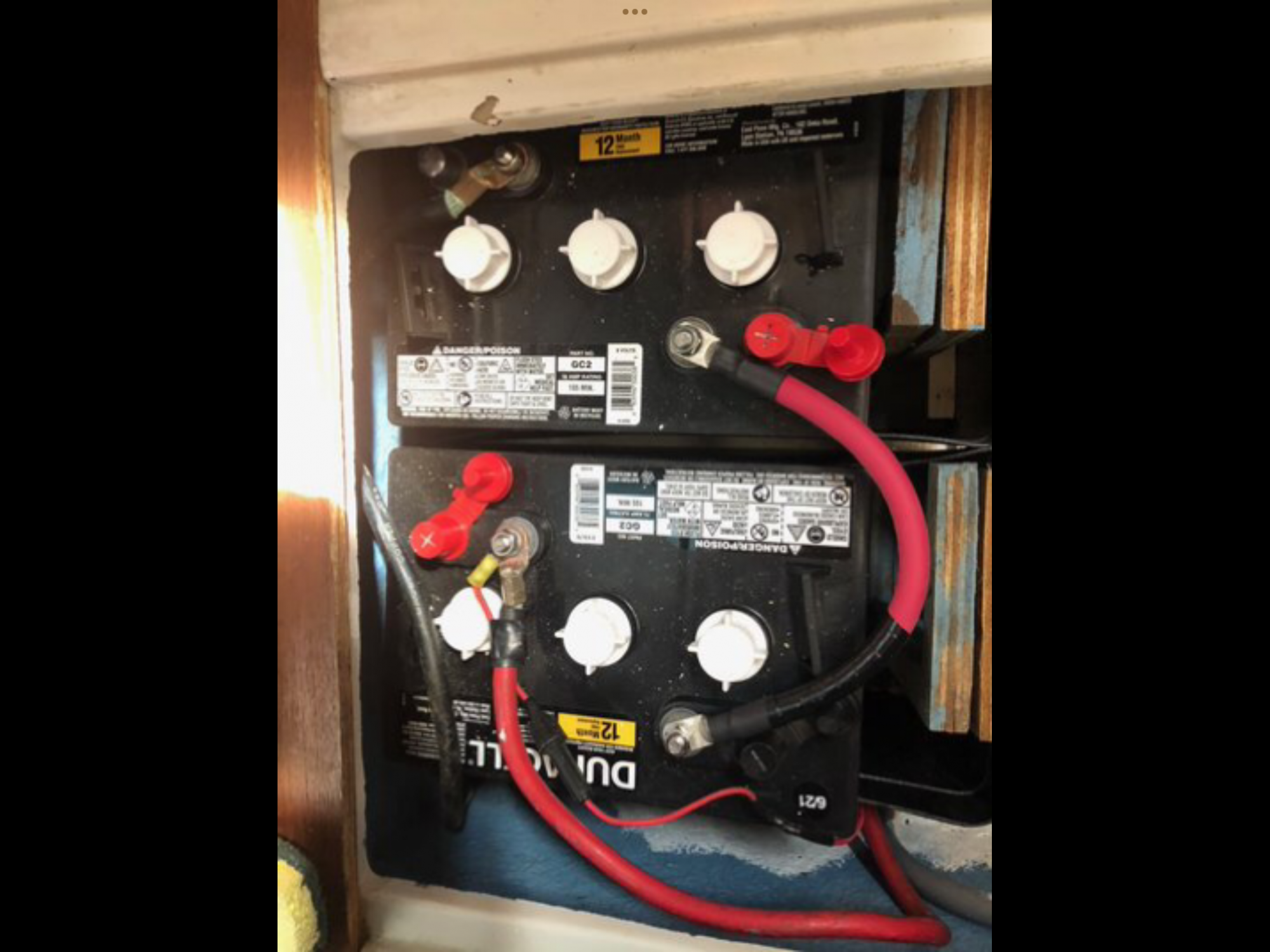

Related question- take a look at this photo of my current installation- the battery terminals and cabling are bolt-in. Is this common? I don't know if this was done during the Northstar installation or did Hunter deliver them that way originally? Wondering if golf-cart batteries can be found that way?
Many marine batteries are bolted. I know that the Trojan T-105's and T-125s are bolted. Some batteries are available from the manufacturer in different configurations.
