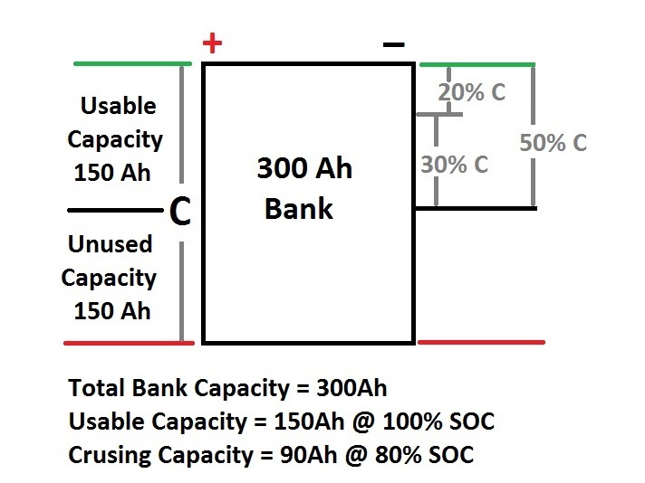

And once you are more than 1 day away from the dock, and a 100% state of charge, your new usable capacity is 30-35% of the rated capacity. When cruising you are cycling between 50% and 80-85% and using only 30-35% of the capacity.. So that 450Ah bank that seems large is really quite small at around 130Ah's of real usable capacity..........
I drew this to try and illustrate what a "cruising" capacity looks like..
