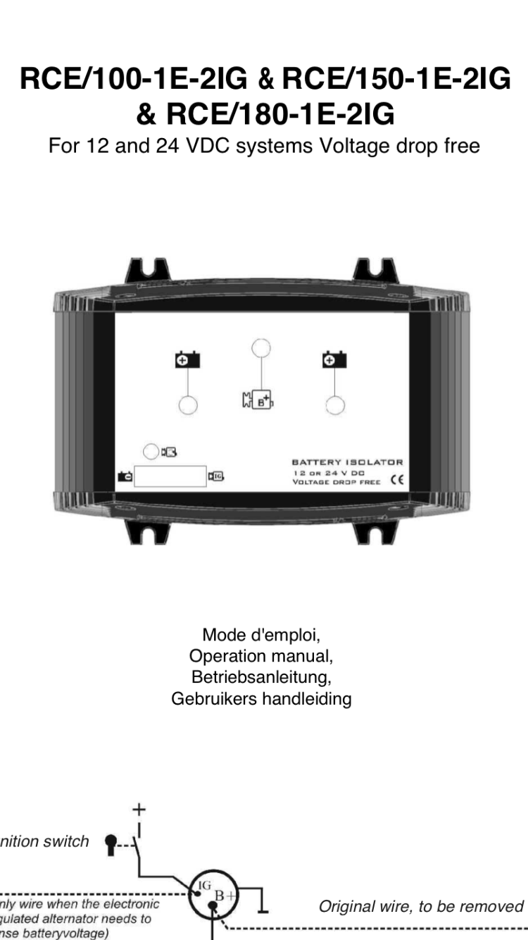

#2 Nearly every Beneteau or Jenneau owner I work for does not comprehend the battery switch configuration. They all tend to assume the start battery is "isolated" from house when the switches are ON. This is 100% FALSE! Beneteau wires a permanent jumper on the "load" side of each ON/OFF switch so that when both switches are turned ON both banks are in PARALLEL..... Beneteau & Jenneau, as brand,s are the two of the boats I see most with two dead battery banks and no way to start the motor. Once you are done with the motor the start switch MUST be turned OFF or you are wired in parallel with the house bank during discharging.
Maine,
Is that true of newer Beneteau's too? As far as I can tell our 2014 came with the batteries separated (the voltages definitely read differently), and there's an isolator like the one I've pictured to charge both banks.
While we're on the topic, how does this type of "voltage drop free" isolator compare with the types you've recommended in the past?
