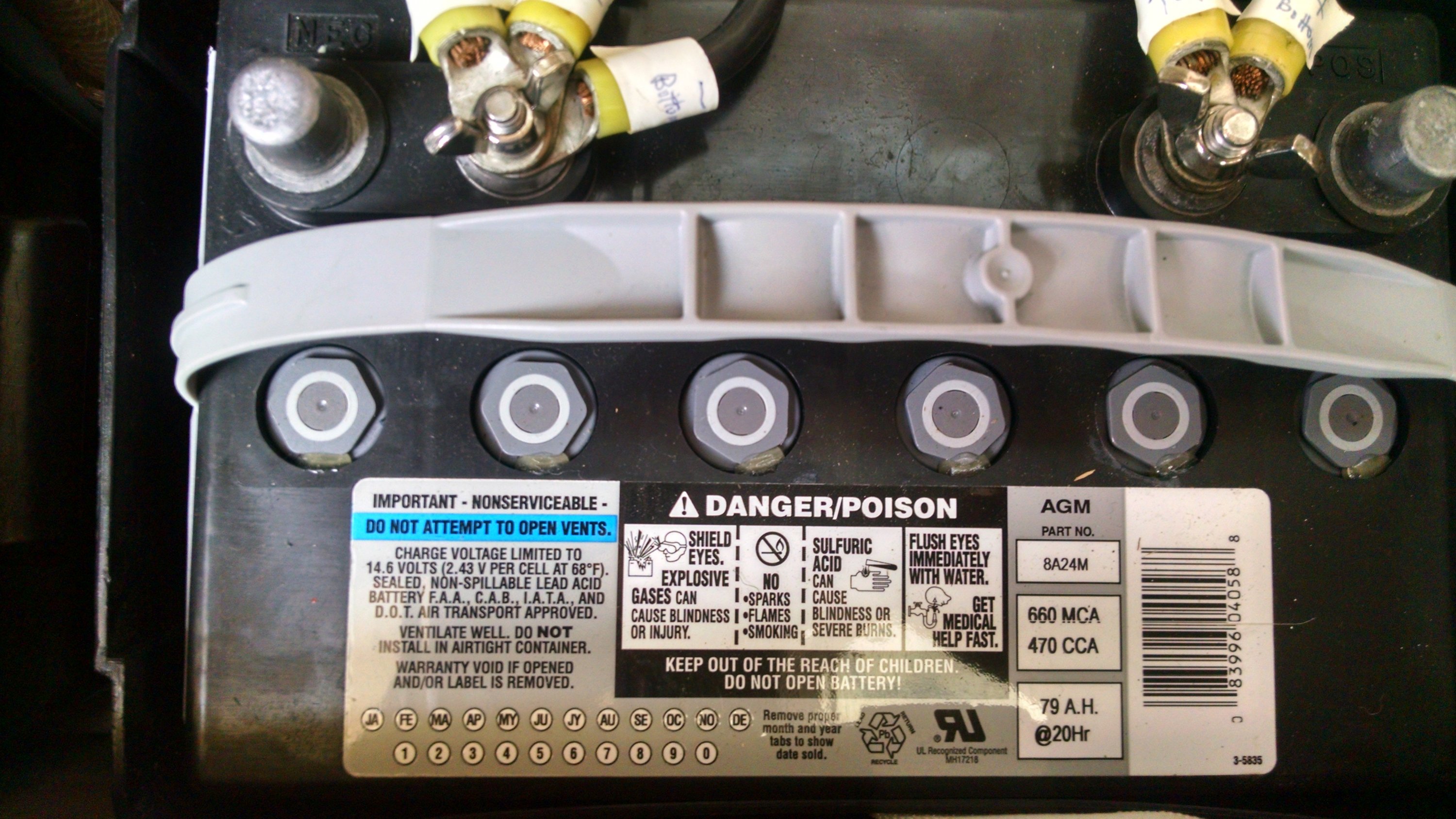

When I bought my boat in 2013 it came with 2 AGM batteries and a 2 stage charger that looks like original equipment from 1997. This was puzzling. I knew I would have to deal with that eventually but there were many more urgent boat issues which required more immediate attention. I decided I would deal with the batteries and charger as a system once something broke. So at the end of my last sail I my #2 battery read 10.8 volts and it appeared it lost a cell. I have no idea how old these batteries are and may have lived a long life and died a natural death as far as I know.
After searching this forum and looking at prices I decided I am not going to waste good money on AGM batteries and will replace them with lead acid batteries. My electrical budget supports that decision as well.

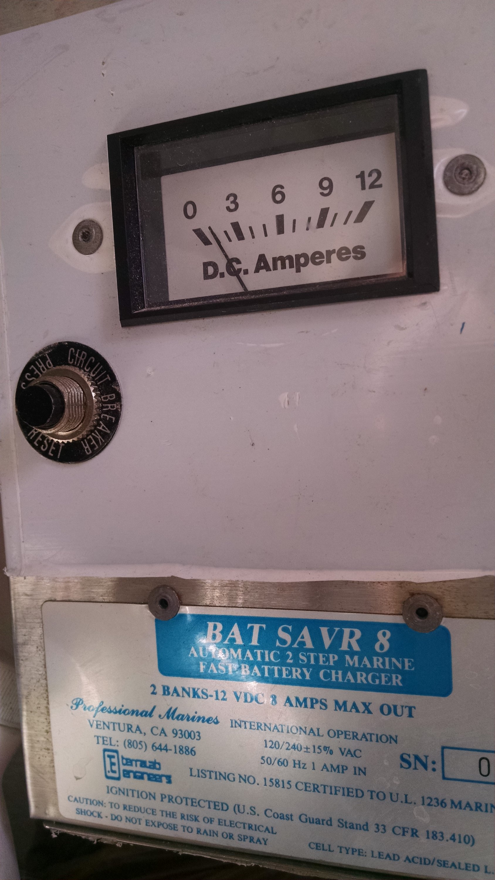

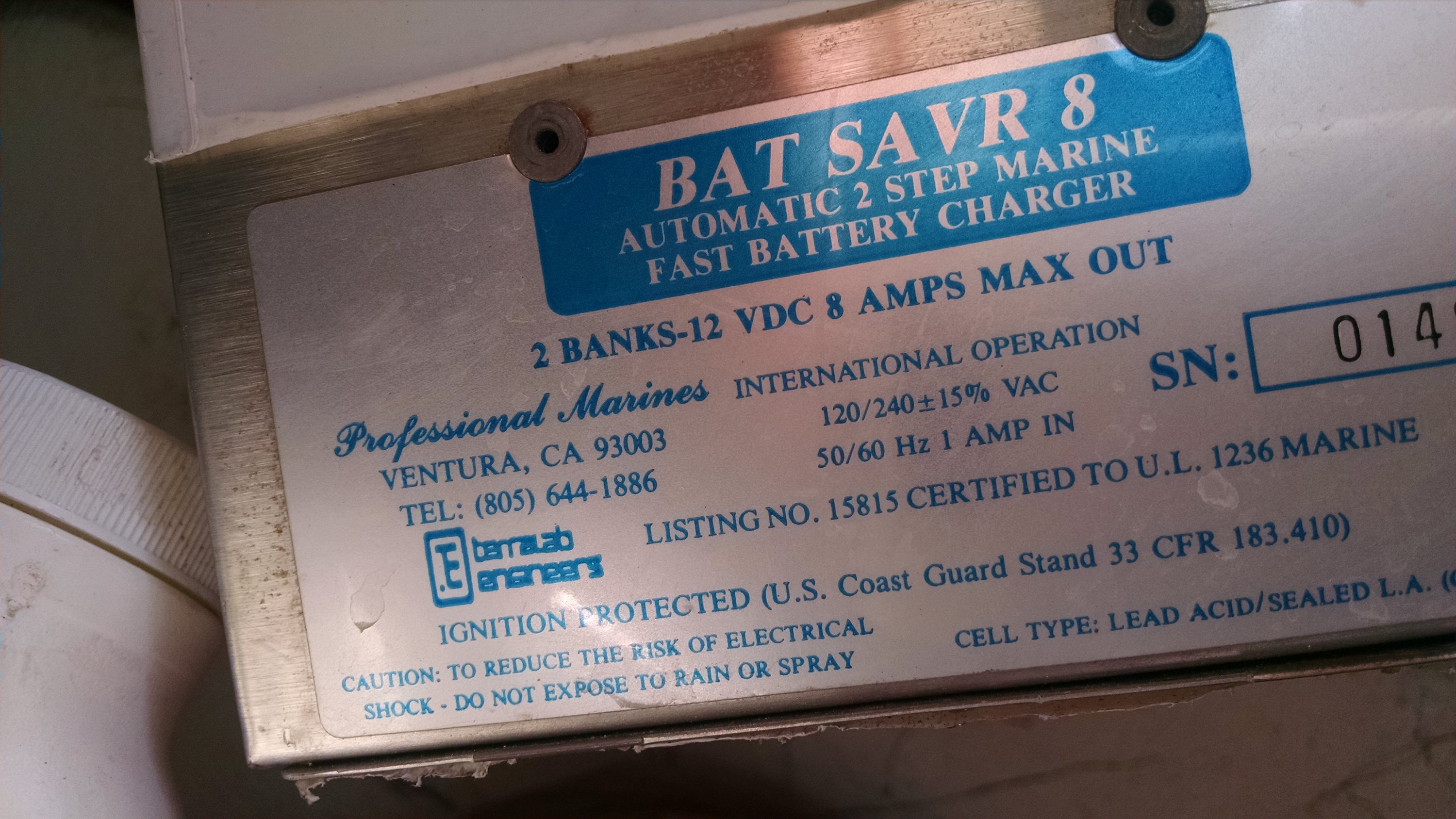

My question is about the charger. As much as it pains me to replace what I consider a perfectly good charger I read enough here that one of the new high tech chargers may be in order. A 10 amp charger will be fine. I have two 79 AH group 24 batteries and an unknown charger whose picture is attached.
From your experiences and knowledge what brand of charger would you recommend? What brand should I avoid? Is the charger I have OK? Am I overthinking this? All wisdom and experience is most welcome

No, you're not over thinking this. The first question is how long do you intend to keep the boat? If you are selling it next year, put a couple of cheap Group 24s in it and call it a day.
The longer you plan to own the boat, the more it pays to invest in a better charger as it will slow the demise of the batteries. The rule of thumb is the charger should be sized to 10% of the bank capacity plus a little extra to handle dockside loads such as refrigeration, stereo, lights etc. For your set up a 20 amp charger would be a better size.
Maine Sail (see his forum on SBO) is a fan of the Sterling/Promariner chargers. Check with him on his website MarineHowto.com for pricing.
