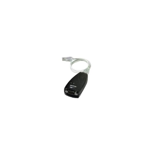

Sorry this basic computer knowledge but one more time....a lap top doesn't have a serial port, just a usb port. So I buy a usb to serial adapter. Plug the usb end into the laptop and the serial adapter into the hand held garmin....I looked up images of usb to serial adapter and the serial adapter end looked rather large with multiple pins inside, in your picture the cord plugged into the garmin looks quite slender

.... a cheap handheld Garmin 76 in the cockpit we bought off e-bay. The computer has a serial port, but if you are using a laptop you can get a USB to serial adapter for under $20 and connect the two all the time or to just download your route into it
The elite has a slot for an SD card Can this be used as an alternate input or like you said earlier its file format is different so it can't communicate in this way. I assume your Cuda doesn't have this input slot so this is why you cant link it to your garmin???....Last question and then I think I will have enough information to delve a bit deeper.
Thanks again
The Cuda doesn't have the slot for the SD card so that is a plus for the newer model as long as the charts don't cost a lot. You can't communicate with the SD slot and you can't use NOAA charts in it.
Now for the connections to the handheld that we use.
http://www.ebay.com/itm/COMBO-CABLE...US_GPS_Chargers_Batteries&hash=item53ddc5fef5
We use a cable like above. The round connector plugs into the Garmin Map 76S and sends and receives data through the 9 pin connector show that attaches to the USP to Serial converter. It can also power the Garmin with the power plug so you don't have to use batteries. You can get extension cables for both which we did to reach out to the back of the cockpit. If you buy an extension cable make sure it is called a "null cable" so that it is straight through and doesn't swap the send and receive pins. Also we run the Garmin all night as an anchor alarm so not needing the internal batteries is a plus. It doesn't consume much elect.
The ship's computer has Serial ports that will handle the 9 pin direct. With a laptop or other computer with a USB port only get a USB to Serial adapter. One I like but that is more expensive is ....
http://www.google.com/products/cata...=X&ei=eFIzT8zwMKaBsgLayISoAg&ved=0CKEBEPMCMAI
....the one above but there are other ones that are much less. I've used the one above for years for data logging info on Hooley's race car. I've never heard of that model not working with an application. Here is a...
http://www.ebay.com/itm/USB-to-RS23...rial_PS_2_Cables_Adapters&hash=item45fa6e1011
...cheaper one. I bought a couple of these to use with the netbooks but I can't remember which supplier or if they are exactly like the one above, but they did work. At $4.00 you don't have much to loose ;).
