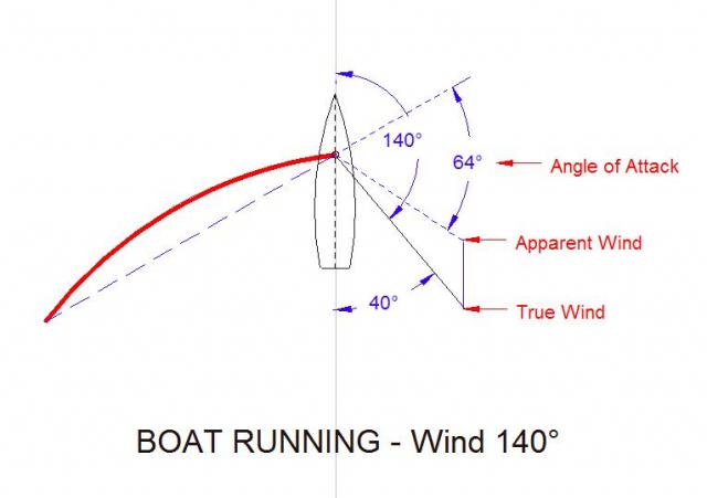

Not quite sure what you mean by "Sail at 120°" but I imagine you mean "Boom let out to 50°". i.e. boom against shroud on a Hunter with the spreaders swept back 30°.
In the case outlined by you with a true wind of 15 kt at 140° and boat speed of 5 kt then the apparent wind is at 124° and the "Angle of Attack" is 64°.
Prof Marchaj's
book Sailing Theory & Practice shows a cambered sail (fully battened) as having a total force of approx 70% of max drive at this angle and it certainly is not stalled.
Have done a sketch of this as below.

Thanks
Thanks for comments and the diagram. Yes I mean the boom is let out as you describe and this would be the theoretical maximum as was mentioned in regards to chafe. The boat speed and TWA and AWA agree with the calculator that I used. It graphically shows what I was trying to ask. The boat in question is a Hunter by the way. The sail is creating drive at these angles but it would appear that all aerodynamic lift is lost at such a steep angle of attack. I learned that when the angle of attack exceeds approximately 15 degrees the sail begins to stall and its aerodynamic lift qualities are lost and it is no longer pulling but instead it is being pushed by the wind.
