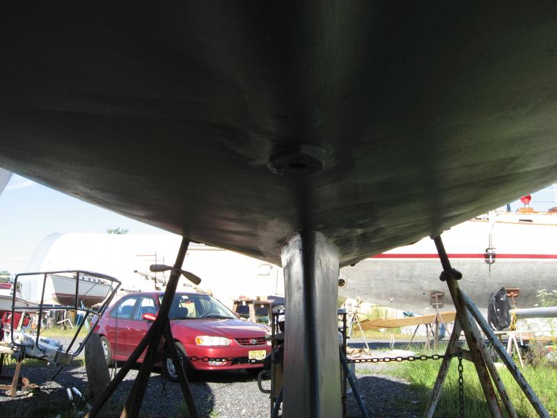

My 1983 H37C has no barrier coat and no blisters.10 years ago, when I had the bottom stripped down to the gelcoat, I debated applying a barrier coat and decided that it was not required. The boat spent the first 18 years in the northern Chesapeake and has been in Nova Scotia for the next 12 years. Colder water and spending 5 months of every year on the hard are not conditions conducive to formation of blisters on a well-built hull. If the boat was in Florida and wet year-round, I would probably go with barrier coat just for peace of mind.
