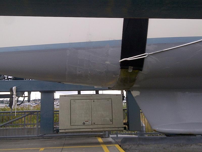

I'm just finishing up a major three week ordeal with defective barrier coat epoxy paint. Sanded her down to the gel coat, and applied 10mil of epoxy primer barrier coat per directions (even consulted the factory). Turns out the hardener in all of the gallon kits (comes in a two part boxed kit) was either really old, or not even hardener at all (it is being evaluated). The paint never hardened (18 days and counting) beyond the consistency of putty. The manufacturer has admitted there have been problems with this lot/batch.

Just out of curiosity, why is the boat in slings? I bet your boatyard is not happy about getting the goo all over their straps. Who are they going after to clean that mess?

The boat is is slings because the project was started at my marina yard where there are no marine stores and only mobile vendors. The paint manufacturer agreed that the boat should be moved to the dealer, who has a full service boat yard. The boat was in the water over night, and at haul out, it was evident that this two part epoxy was water soluble.

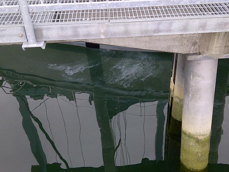

They say they won't work out of WA state, but in my experience companies hate being contacted by the government. For example, it is probably a violation of some EPA laws for them to sell an epoxy product that dissolves in the ocean.

I didn't grab the acetone, but did grab the soap and water, since we knew it dissolved in water. In fact it did pressure wash right off, but the yard manager stopped it for the obvious reasons. So my wife and I grabbed a couple of wide putty knives and scraped off two gallons. Saturday and Sunday I got it all off with Dawn detergent and water. As of today I've recoated with four coats of Interlux 2000e (which I did test), one coat of hard bottom paint and a first coat of ablative. Tomorrow will be 2nd coat of ablative, then move the stands and do the cycle again. I do still hope to recoup my expenses from the manufacturer using some of the ideas above.
