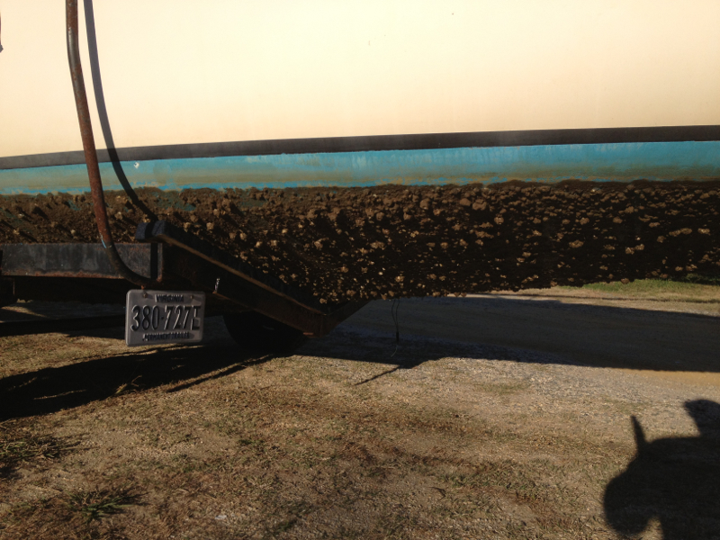

I'm thinking pulling and cleaning (if its easy to pull) is not a bad idea. This is 7 months after applying new bottom paint. Seems I could have just as we'll used cheap Walmart paint to get the same results. I will be cleaning mine monthly and won't waste good money on bottom paint.

Mine looked like that to, after two years just setting in slip.
PO did not clean bottom or top side. Pressure washing helped,
But then there were a lot of barnacles. I scraped, but still had to
Remove the feet left behind.
