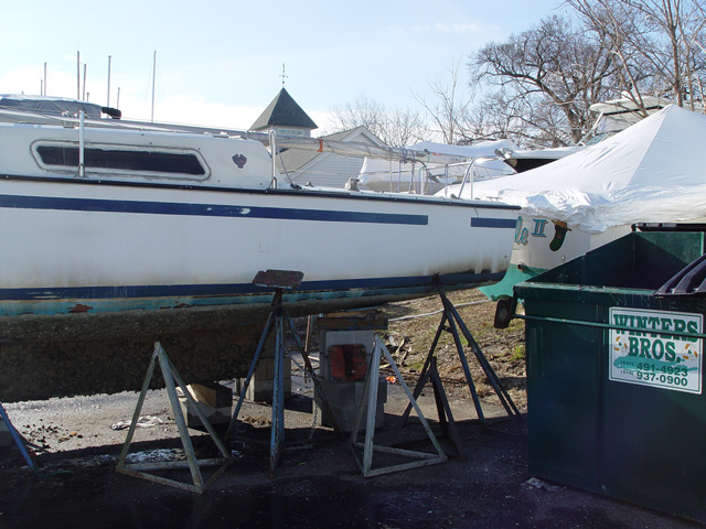

My Mariner is at the marina getting power washed today. I stopped by and the owner let me know that it was taking longer then expected...I think he wanted to change the pricing on me as I was staring at my boats broken tiller. hmm...
Anyway,
Barnacles were coming off so if you have a power washer try it with a scraper to help it out. Here is a pic of how bad. He may be using an acid but I don't think so.
