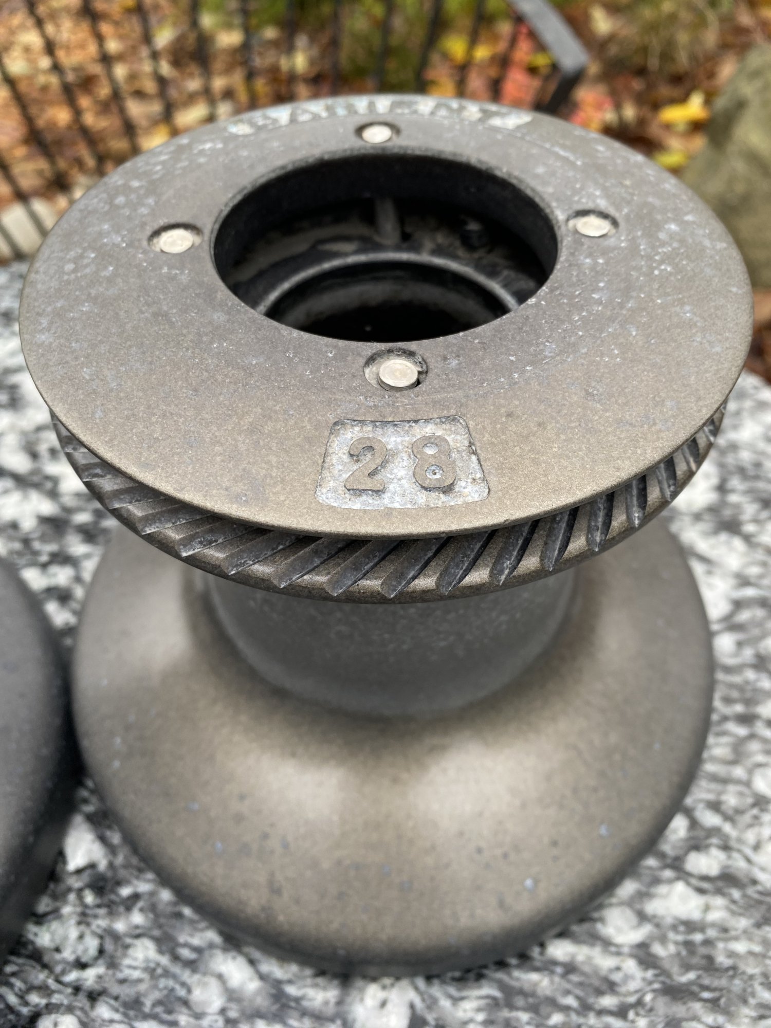

Hey all,
I just serviced my Barient 28s (original on '85 C&C) and was relieved to see the POs have taken care of these winches—internal parts are in great shape. But the anodized drum is showing some oxidization. Scrubbing with bronze wool and vinegar helped a bit. Would muriatic acid work better, should I try something else, or is this lost cause?

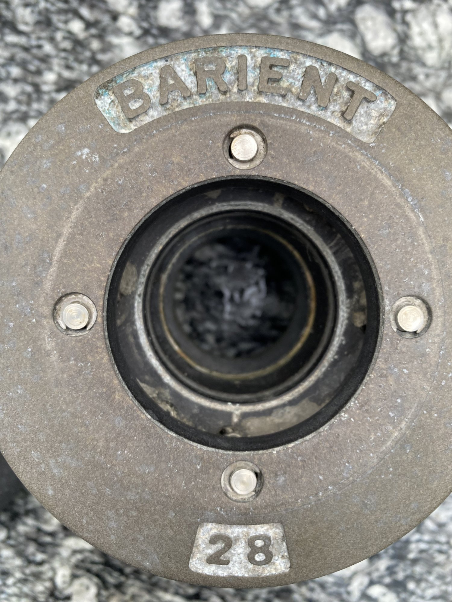

Had to wait for better light to bring out the green spots in a photo. It's mostly a cosmetic concern, but given that anodizing has a life and these winches are otherwise in great shape, it might be worth reanodizing them. I know some have actually painted these with an etching primer and then a Rustoleum product. I've got my doubts about the durability of that finish. So the questions are:
1. Will anything take these spots off w/out harming the anodizing? Thanks Roger--I won't be using the muriatic acid and will look into the Meguiar's product.
2. Down the line, I'm pretty sure that reanodizing will be way cheaper than replacing the winches. Any members on the forum have experience with this? Recommendations?
3. Any experience out there with removing the self-tailing clamp ring in order to clean/lub in there? Or is this needed? Nothing in the manual addresses this.

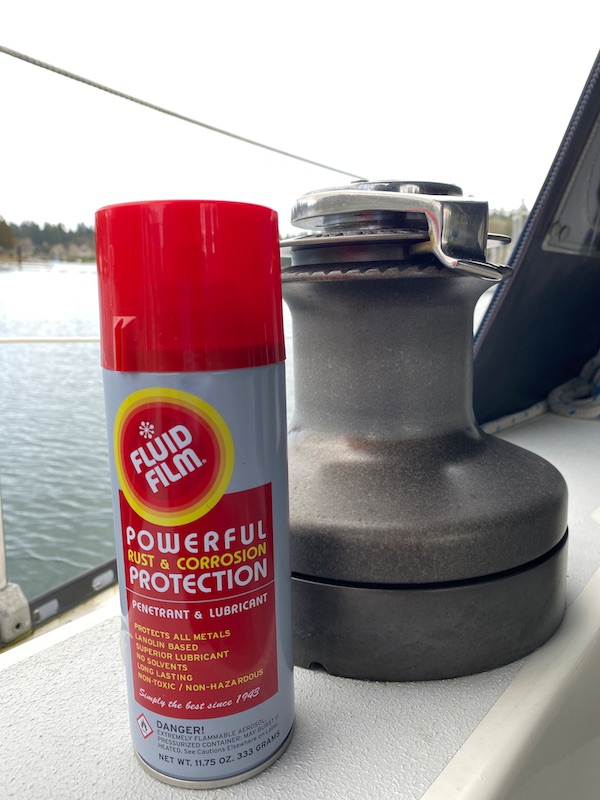

Late followup here. Thanks John for the LCR product ref. While perusing the lawn implement isle at Home Depot I came across a lanolin based spray by FluidFilm with no grease or solvents. I sprayed it on the drums and rubbed it in. Appears to be the ticket for cleaning up the spots to about 60% and giving a decent protective coating that is not sticky or visible. We'll see how it behaves in the heat.
