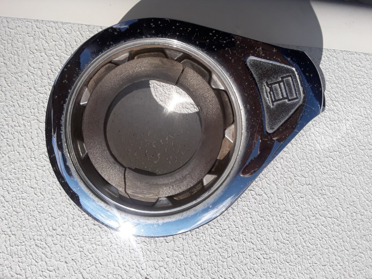

One disappointing thing I found was on my deck mounted halyard winch. The pivot pin for one of the gears sits in a hole in the base of the winch. The hole is wallered (sp?) out and the gear wobbles. I am in search of a used base. I contacted the Australian Yacht Winch Co and they responded with a request for pics. All I had right now is a top down shot so I'll see if it's enough.

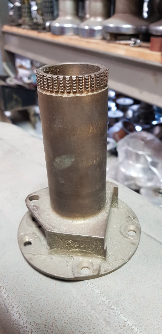

The culprit. I can get this replacement part for $220. That will be Plan B if I can't repair mine. The worn out hole is in the base below that upper hole on the left. It has a flat "boss" that the gear spins on. I may need a thin brass washer to act as a bearing surface.

The upper hole looks a bit elongated as well. If so maybe reason the gears had difficulty meshing.

:) This pic is from the seller. That's supposed to be the one he wants to sell to me.
