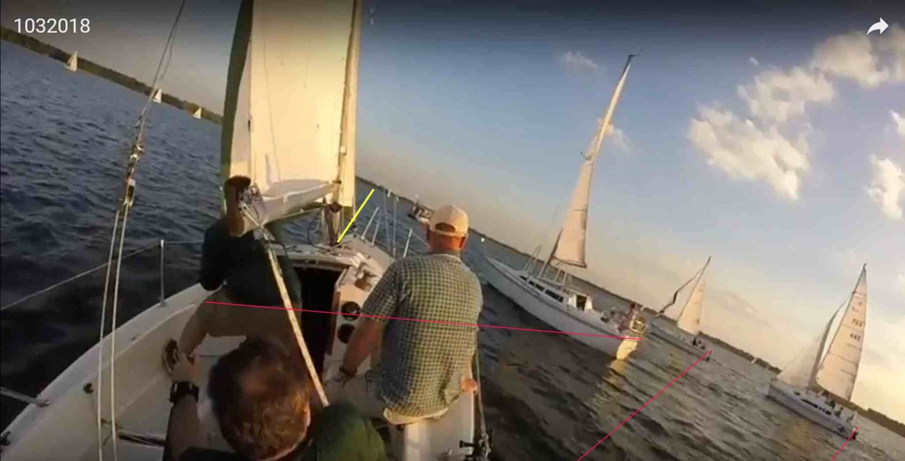

The boat on which I crew did our first protest last night. It was a very fun race, and a very exciting start. I'll see if I can post a link to the video here. The Catalina 27 you see in the video was only "racing" to get the points, as she was alone, but unfortunately she chose to be on the aggressive end of the start line.
I'm the one waving the protest flag, and this was the first time any of us had done that, so I'll admit that I may not have executed the protest correctly.
Thought I'd share because it was very exciting (for me anyway). :)

But what a mess. Here are some thoughts.
The C27 clearly fouled you via RSS11. Her action was not aggressive, just ignorant of the rules and her surroundings. She should not have been there, and didn't see you. The other boats were aggressive or unaware of the rules.
The Hunterlina 25 fouled you as well, as in both cases you had to turn down to avoid then.
The boat that passed closest to the RC boat did not foul you, but fouled the 25. The 25 might be able to get exonerated if she can prove that she could not go up because of the other boat to windward.
Did you file a protest? Was it upheld?

JD, thanks for the input and yes, it was quite a mess and very exciting. The racers in question ALL know the rules, even the young lady. The wife of the skipper on the Hunter, who was also one of the Hunter's crew last night, is the one who actually explained the rules to us a couple years ago when she witnessed a boat barging us where we failed to protest. I'll make note of the rules regarding protests from now on. I don't know if the C27 did her spins, but the Hunter 260 says he did, and I believe him because he's a pretty stand-up guy. We ended up winning the race, but we probably would have lost to the Hunter if he had not done his spins due to the time we owe him on our 3 mile course. His phrf is 228 and ours is 200. That C27 is usually one of our toughest competitors, but last night the young lady was alone and not able to properly race. I think she started on the aggressive end simply out of habit.

They are overlapped with the C27 the entire time its in the picture. The overlap line is drawn perpendicular to the ahead boat's centerline, across its transom. If any part of the trailing boat is over that line, there is overlap. So per RSS11 the windward boat must keep clear.
The word barging does not appear in the RRS. It is a term that describes any boat that is above the layline to the RC boat. In this situation, you are windward to all (starboard!) starting boats, and must reach into the start while they are close hauled. It is terribly risky because you have no rights whatsoever and your only hope is to be able to cross over them, or tack on their line. Remember that there is no mark room at the RC boat, and no such thing as proper course before the start. Otherwise you have to bail out. In that video every other boat was barging.

Following for learning. My first race was a drift fest at the start so nobody was making any great headway. It looked very similar to the video. I was the windward close hauled starboard tack and just trying to maintain some headway and not luff my sails. A Hunter 25 was coming from behind and said I was barging him which was confusing to me as I was maintaining the heading I had been and had not changed it or adjusted it to cross him. He was moving pretty well but as soon as he came along us we blocked his wind and he sails stalled. At this point we had not crossed the start line. I assume I did something wrong, but just don't understand what or why since I made no advert or intentional moves to block him. In fact I even asked him what he wanted me to do and he said don't worry about it and did not protest.
My first race was just for fun and to se if we could do it and this has sort be bugging me a bit as the last thing I want to do is go out and mess up others be being clueless.

It's REALLY hard to barge if you are close hauled. You were probably reaching but didn't know it. I see this all the time. In the screenshot below the video boat IS close hauled and on the layline. They've got it nailed. The red lines show the transom/overlapped lines. Everyone else is:
1) Reaching
2) Windward
3) Overlapped
4) Barging
The lady in the C27 might not have thought so but you cat see she is. Remember, if you are close hauled the only thing a boat clear behind can hit is your transom. That's not overlapped, so you maintain ROW.
Like jackdaw said, you may have thought you were close hauled, but either you actually weren't or he was in a boat that could point higher. The fact that you didn't change your course doesn't really mean you weren't barging. Fact is that if it's before the start and there's a boat closing in from leeward of you, you're probably wrong. He has rights, and his only obligation is to give you room to keep clear (no sudden turns that you can't avoid). Good for you though for learning. Next time it happens you'll know what to do. And maybe the time after that you'll be the guy in the favored position.
