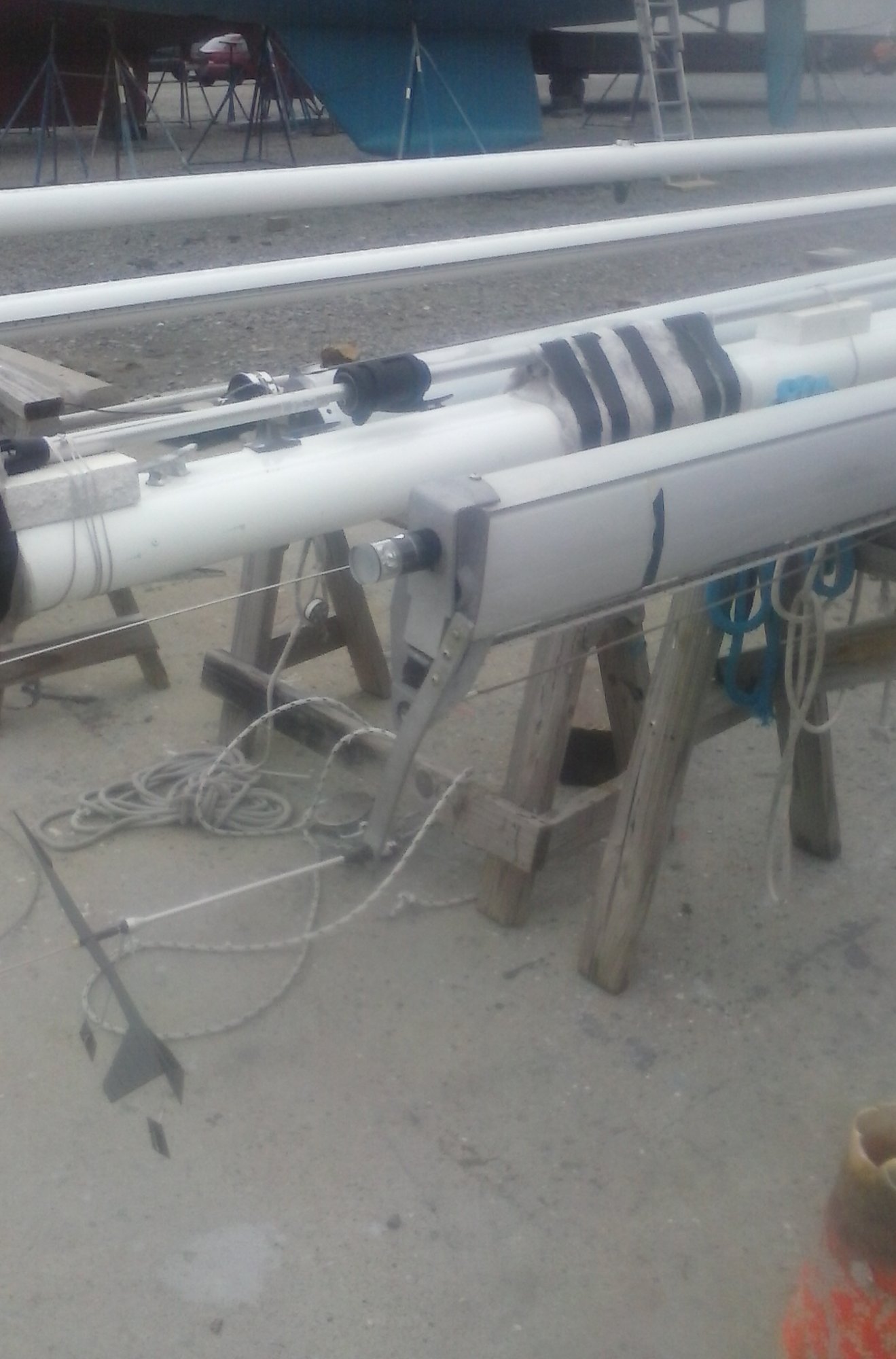

I have a question about my unpainted mast and boom on my 1979 Cat.27 tall rig. Is the aluminum anodized? If so how can I clean and polish them without causing problems with the anodizing?

They used to make aluminum cleaner (that would remove the oxidation); and, then you'd wax the alumimum. If the anodizing has worn off, then you can try to clean it and wax it.
24,589
What is your goal? A bright and shiny mast? Then have at it. Eventually your mast will get wear spots and they will turn dull slighty grey. It is like trying to plug the holes in a sieve. A game of Wack-a-mole.
Or you can clean the mast of the ugly spots. Rub with a fine scotch pad. And let mother nature take over. The Aluminum will oxidize and form a fine film that will protect the metal from further corrosion. It will have a matte light grey look like many of the aluminum masts in the marina.
And go Sailing.

I just want to clean it up but don't want to hurt the metal if I use the wrong wrong cleaner. If it is anodized I think I don't want to use any acid type or abrasive cleaners. I'm guessing.

I can't say specifically about your mast, but often, they are not anodized. As js says, the surface oxidation becomes a self-protecting barrier layer that prevents further oxidation.

I had a 1978 Hunter 30 that had an anodized mast.
As I remember I just used star brite polish on it and that was all. Wiped on and wiped off, not to much elbow grease needed. Went thru a lot of rags.
I would not use and acid type products just soap and water and a good brush to remove the heavy grim and oxidation. The cleaner wax will do the rest.
