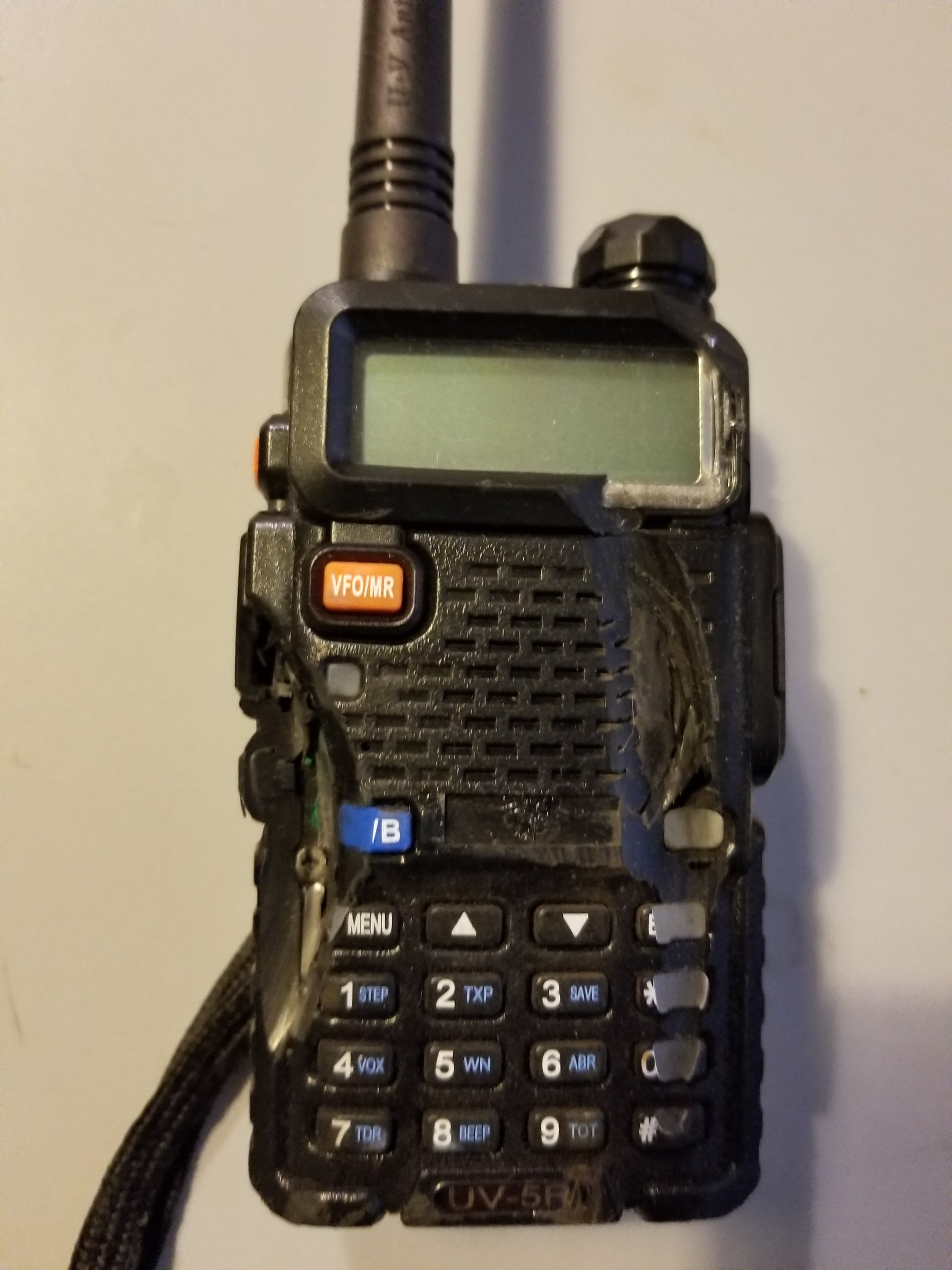

pateco
Aug 12, 2014
2,207
I am now on my second one. Try not to drop it into a running diesel engine compartment LOL
Good thing these are cheap, I would not have wanted to do this to a $200 radio.
