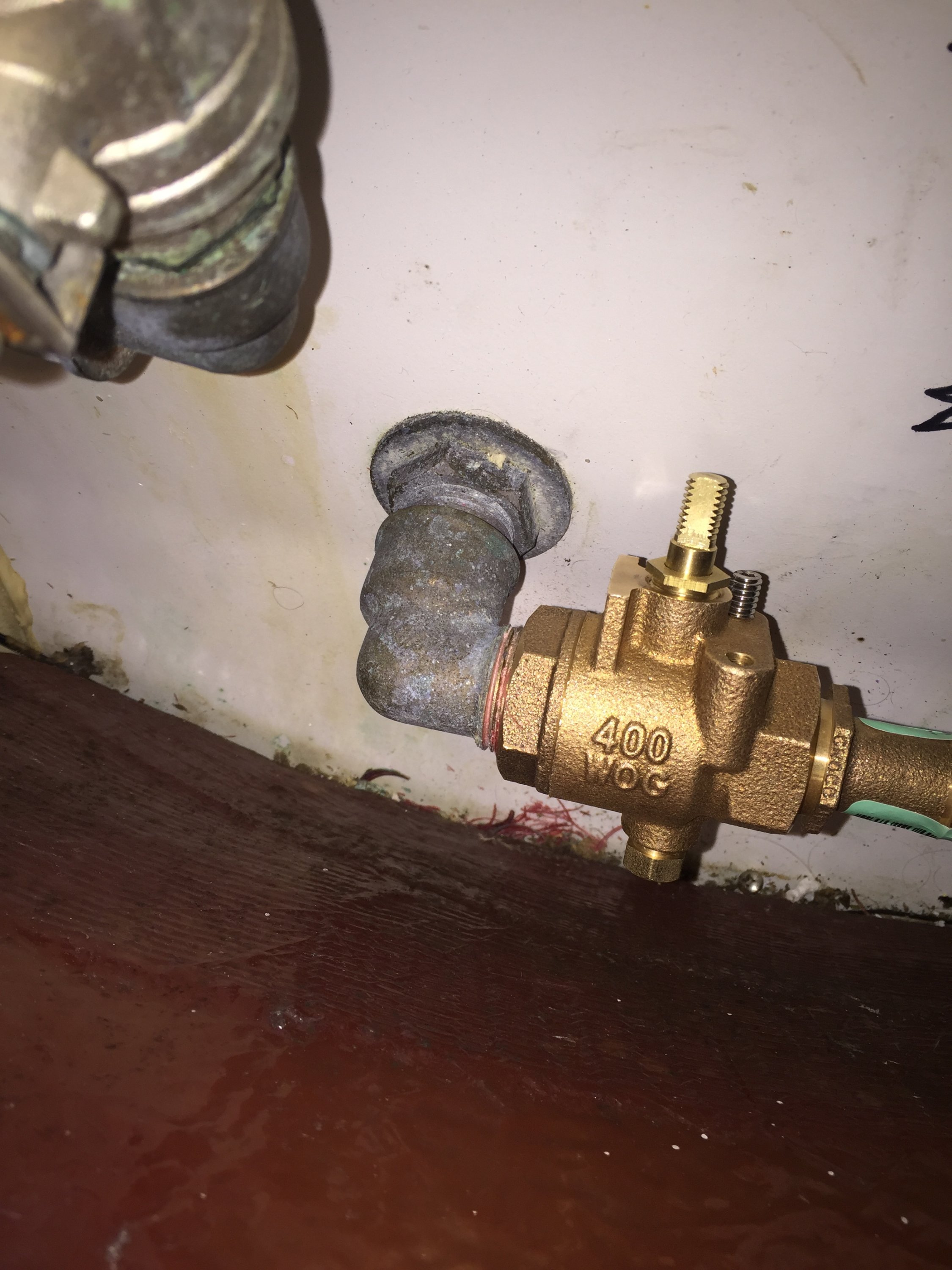

So part came in, went to boat and what do you know.... fits. Again thanks for the direction. However, when looking at the set-up it looks like beneteau used different metal for the street elbow and fitting. Also other ball valves that are original all do not look bronz....... or is that just aged (2005).

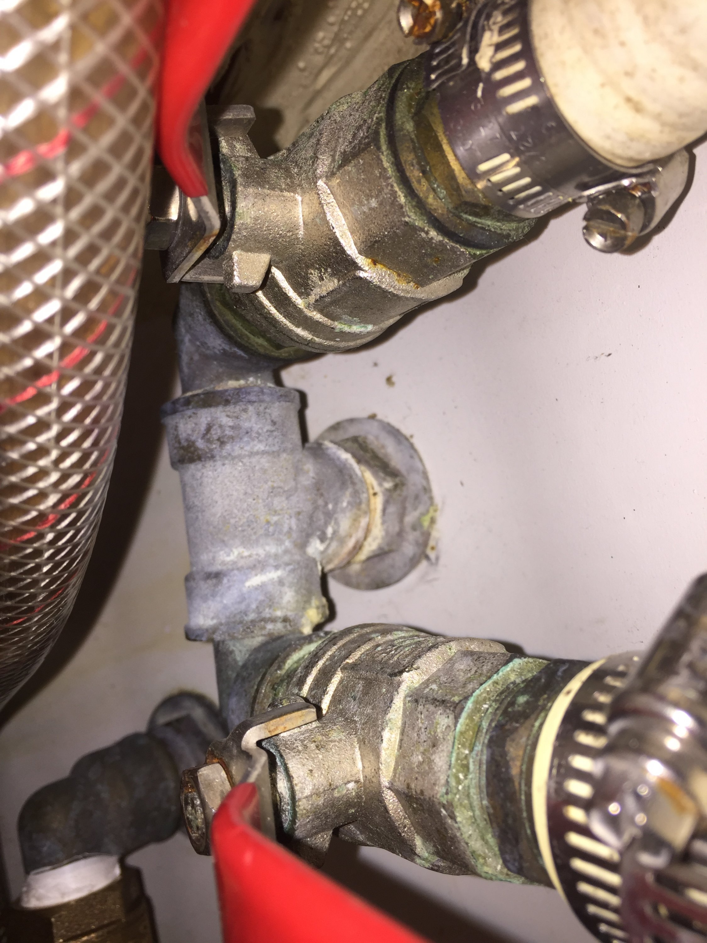

Beneteau used brass below the water line?? Seems nuts. So this combination.... Brass thru hull and elbow to bronze ball valve is a disaster waiting to happen. And not just that.... if it is the case that Beneteau used all brass fittings below water line then all thru hulls are suspect??

Beneteau used bronze for the thru-hull, but you don’t know what the previous owner did with fittings beyond that. Looking at the elbow I think I see a fracture in the thread next to the the valve.

I does look like a possible fracture in the thread. Also, the thread area is pinkish in color that could signify dezincification. They may have used a type of bronze that has a higher than normal zinc quantity.

The pink stuff is a thread sealant..... think the fracture is the light, however I will check closely today when at boat...... cover comes off! Thanks for the good eyes!

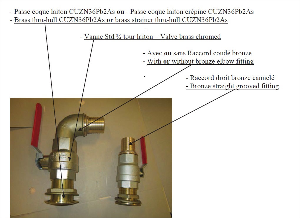

Well that is a relief hearing..... everything on boat is original. All fittings look the same.

Don’t know first hand what they used for the thru hull fitting; however, the ball valve was very light in color—doesn’t appear to be bronze.

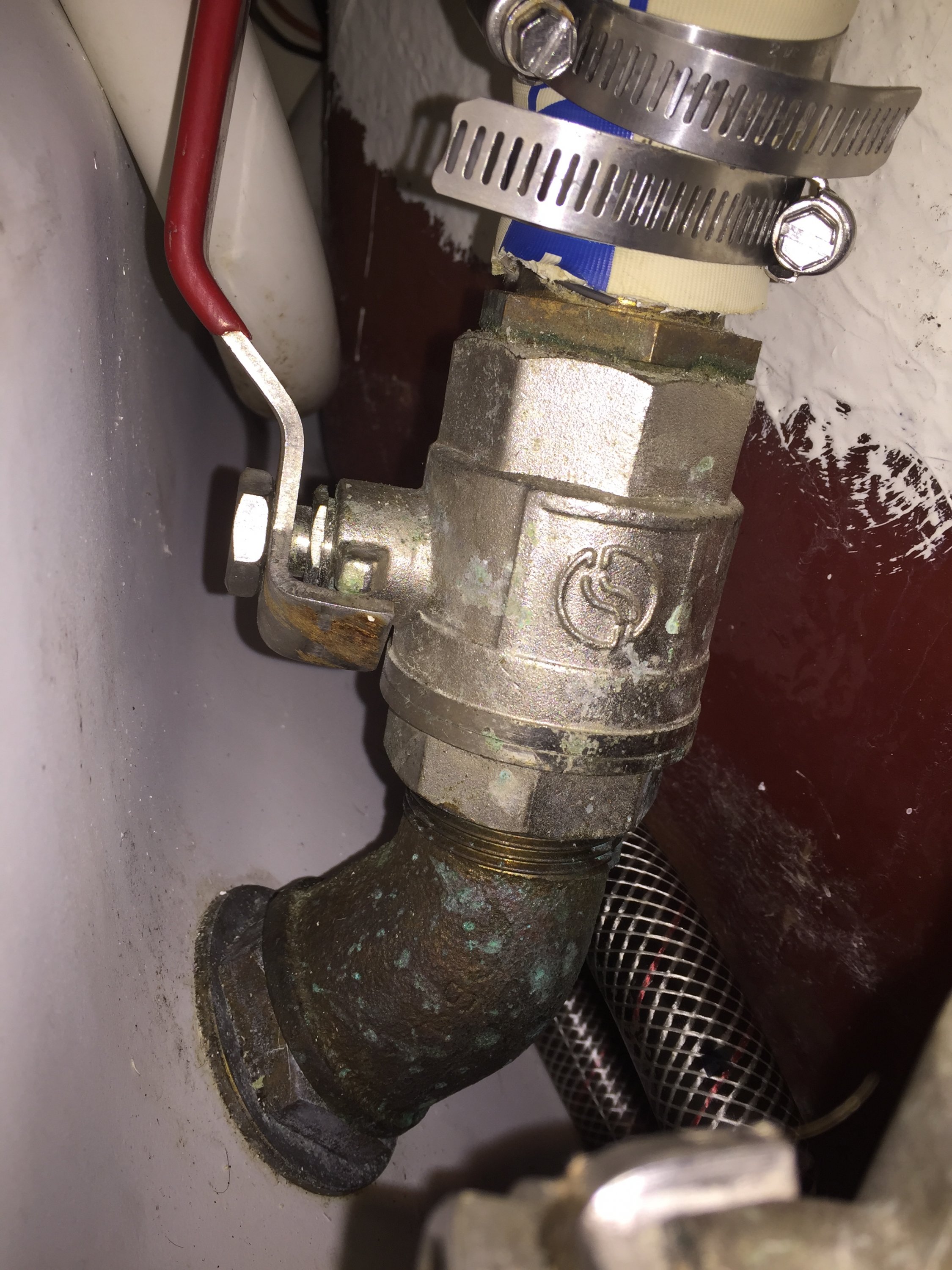

A few other ball valves on boat......
Just don’t look like typical marine, however all appear in good shape

I have wodered from they day I got my boat why the ball valves appeared to be stainless whilst the through hull fittings were bronze. The boat has only been in fresh water, so no outward signs of corrosion after 13 seasons.
