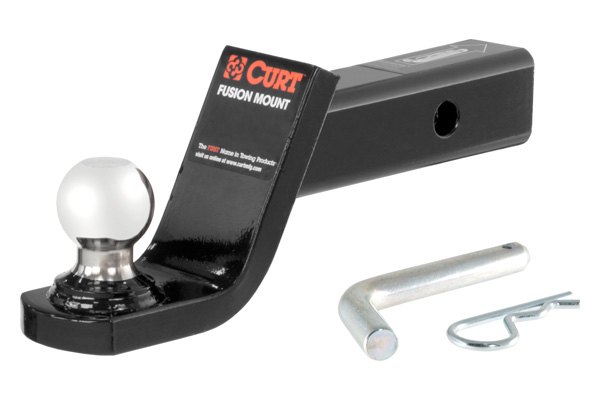

having sold several thousands of theses back in the 70's out of my shop ...the one pic on the top is a ball mount (male) ...and the pic on the bottom is the receiver(female)...not trying to be a smartazz here just clearing up the info.......
