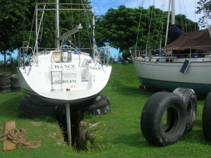

Has any one seen the keel pits used in the bahamas when a hurricane is about to strike?
I understand they get a back hoe and dig holes and crane drop the boats keel in the hole !! The jack stands tend to fall over in a bad blow..

Hurricane holes are small, protected anchorages commonly located around Carribean islands in which you might be advised to pass a storm. However, a quick review of the subject on the web indicates that they have their detractors as safe anchorages. I have been around a few marinas in the Carribean, and I have never seen any yachts sitting hull-down in the dirt... purposefully, at least. Here is a photo of a hurricane hole in Melenesia. It is also called a keel pit. It seems that they should unstep their masts to be truly safe from the wind.
Thanks, Andrew
