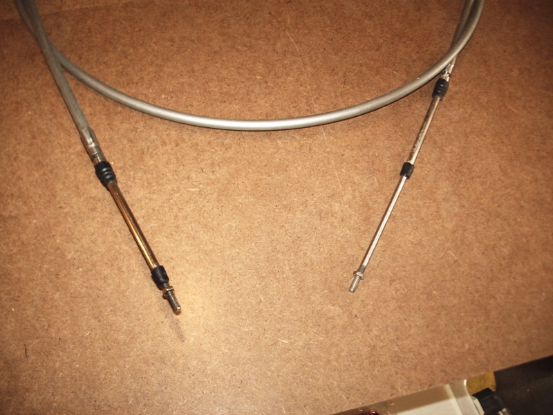

Ericson 28/2 Port Kent
The cables on my old E-28+ were a Morse 34C, 10ft. and a Hondo 2191 at 10ft.
Correction the Morse was a 33C. The picture is of the cable ends.PICT0160 (800x600).jpg
