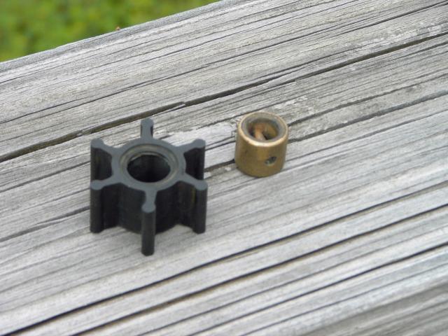

Over the weekend I had a nearly new Yanmar impeller spin the center hub and quit working. Have attached a pic of the offending part, with the hub removed. Has anyone ever seen this before, and if so any special circumstances. I found nothing in the pump, that could have caused it to try to hang up and spin the hub. I guess it is possible, but sure didn't find anything. Of greater interest to me, is there is no sign of any bonding between the hub and the impeller body. No sign of high temps that would leave some burnt neopreme on the hub. Would not think these are just a press fit, with out some type of bonding agent. The hub pushed out very easily, so there is certainly something that either I or the mfg. missed. Ideas welcome, and I am going to take this with me to the Yanmar dist. here, when I replace it, and see if they have anything to say.

I think I mentioned this once before in another discussion that I too have had this happen. It can be a frustrating experience as in my case, there was no apparent problem with the pump and everything appeared to work except no water. It didn't occur to me that this separation was possible until I ripped the entire cooling system apart before finally realizing it was the impeller which appeared to be fine until I tried running it with the cover off.
I should mention this only happened once to me but now, I always add to my routine maintenance procedures to check the rub/impeller bond.

I just pulled one of my spares out (Johnson pump 09-810B-1) I think it is the same or similar to what you have. I notice that the bolt that goes through the hub is flush with the rubber on both sides. As I recall this is standard for the type. I assume the pin in yours is much shorter or it would have torn-up the rubber when it spun. Maybe yours is not a genuine Johnson part -- it should have Johnson and the part number on the hub.

I've had that happen but only with the aftermarket Globe brand impellers. As TMS said some of the Johnson impellers have the bolt that goes through the hub and rubber..

Some years ago, Yanmar had a run of impellers with faulty bonding that would do as yours has done. May have been one of those that finally gave it up.

Manufacturing mistakes happen. Take it back to your Yanmar dealer and get your money back. We expect our impellers to loose vanes and clog our cooling lines not to spin on their hubs.

Nice/Easy.. I was talking to another guy from Mandeville who does some diesel work and he said that he's seen this failed bond thing before on a Yanmar impeller. It would have taken me a while to get that one, so thanks for posting.. If she overheats, it will be checked!

Went over to LaBorde ( Yanmar Dist. ) yesterday, and got replacement impellers. They don't even want to talk about failures. Totally non commital, and about the only thing they had to say was how long ago did I buy it. Kept telling the guy I didn't give a rip about any warranty, just wanted to know if there had been failures. Just a blank stare. I did buy two impellers, and two different brands. One Yanmar, and one for a Johnson pump. The Yanmar impeller is just like the one that failed, but the Johnson impeller has the screw through the rubber and the hub. Seems much more secure to me. Other than that they are identical, except that with the Yanmar you get the impeller in a little baggie. With the Johnson you get an impeller in a box, along with an instruction sheet, which I have yet to read, and a little tube of lube. Exact same price. Will probably not buy another Yanmar, as the Johnson sure looks to be a better mousetrap.
FWIW, the Johnson part is OEM. Johnson makes the pumps, not Ұanmar. Who knows what the Yanmar part is -- be happy they didn't paint it. :)
