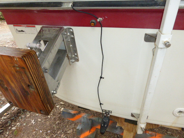

Pat. I mounted the transducer on the transom ONLY because there had been one there previously, and the wire retainers and hole for the wiring was already there. the potential issue with mounting the transducer on the transom is that it could come up out of the water if you encounter much heavy wave action, and/or healing over of the boat. the potential downside of mounting it inside the hull is that you could have an air pocket in the hull or bedding material that would make the unit perform poorly. even the thickness of the hull must have some effect on it's function, but many folks do it that way without apparent issue, so pick your poison.
if you do decide to mount on the transom, place it as low and as close as possible to the centerline of the boat without the rudder or prop hitting it when turned to the max.
